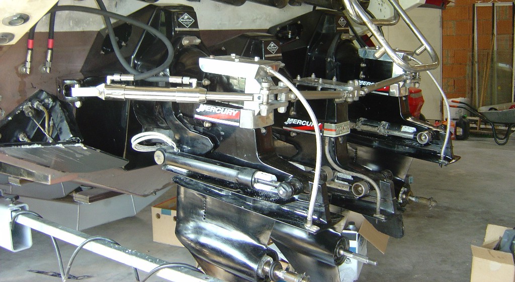

Old 11-10-2010 | 11:28 PM
Joined: Mar 2007
Posts: 276
From: Gelsenkirchen, Germany
Cool 419 Sr 1
419 SR1
started as TWIN engine boat
twin 465 - 55 MPH
twin 465 with Pro Charger 70 PPH
lasted 10 hours only
Triple 496 HO `s 72 MPH
Triple 496 HO `s upgraded to 525 HP each 79,8 MPH GPS
Imco Extension Boxes 3 `rise
Bravo 1 lab finished props 30
Boat planes on any 2 of 3 engines with the 30 `props
Go with Imco SCX drives if you exceed 600 HP
just my 2 cent
Attached Thumbnails 419 sr1 Formula-imco-boxes.jpg   419 sr1 Formula-k-boot-bs25-a1.jpg   419 sr1 Formula-k-boot-bs23-.jpg
