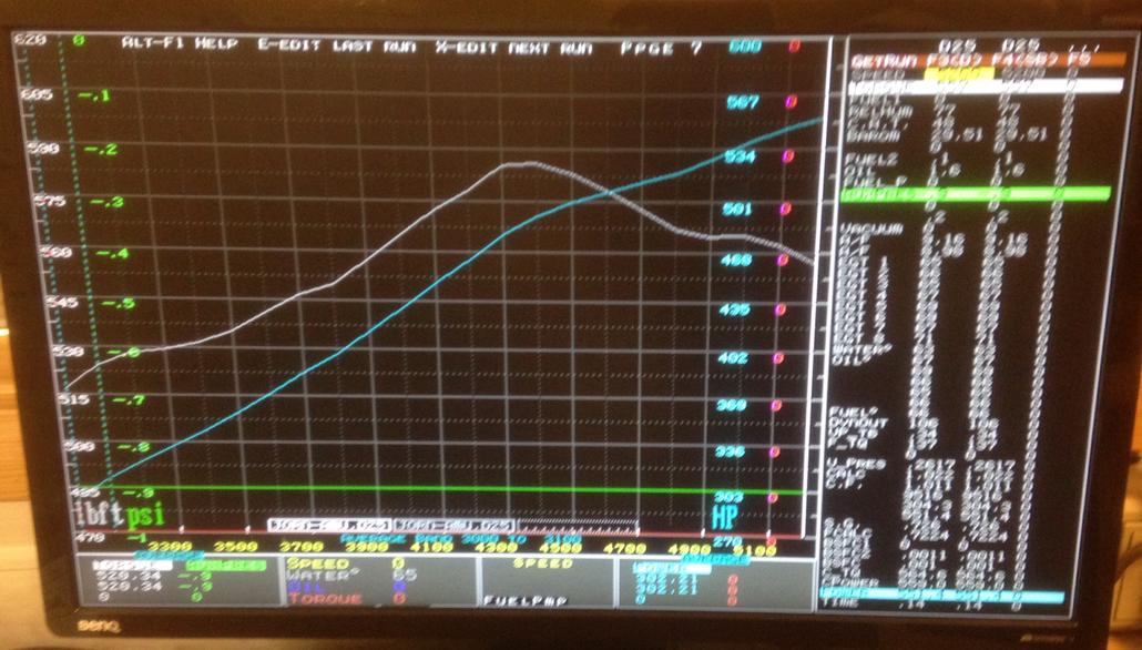

I tested my brand new Bravo1 24' ( if you messure a bravo 1 prop you will find out that it is aprox 1,5 pich less then it says. Mine was 22,5) this is how it preform :
Straight out of the whole, very quick ( have K Planes as well)
I hoped for 36mph at 3000 rpm ( low cruising speed) I needed 3400rpm to reach this :-/ prop seemd litle loose
I hoped for 46 mph at 4000 rpm ( high cruising speed) I needed 4200 rpm to reach this :-/ spinning a bit
Now the good part a very strong acceleration from 3500 to 5000 rpm :-) :-) ( still spinning, but real fun )
Top speed at 5500 rpm 65 mph ( 5 less then my goal)
At the Dyno test it was 560 hp at 5200 rpm
As I see it I have to options get my prop guy to cup my Bravo 1 24 to give a better grip, or go for a Bravo 1 26 pich. That means a 24,5 pich in my book
I would love feedback and comments :-)
