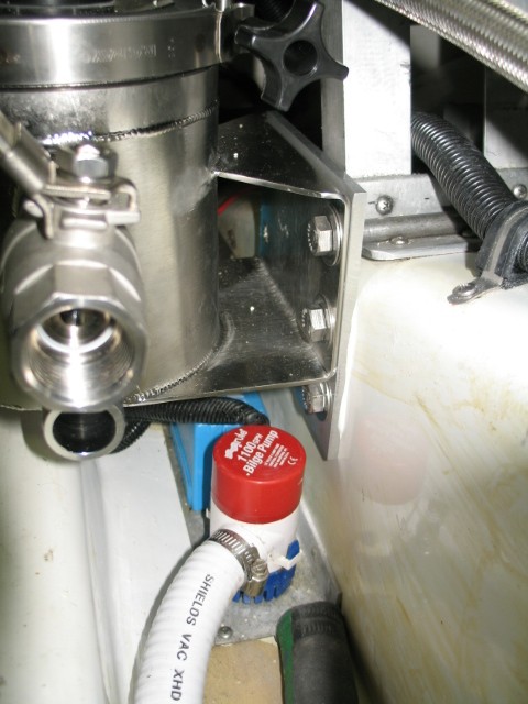

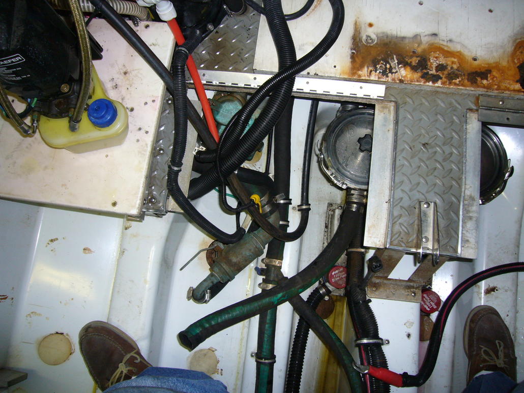

Here is the original and updated versions of the strainers in my 2000 382. I left them in their original location, but relocated the in and out fitting locations and added shutoff valves.
More details on this thread.
Attached Thumbnails Strainers on a 382?-platformcenter20071103b.jpg   Strainers on a 382?-platformfwd20080407b-large-.jpg

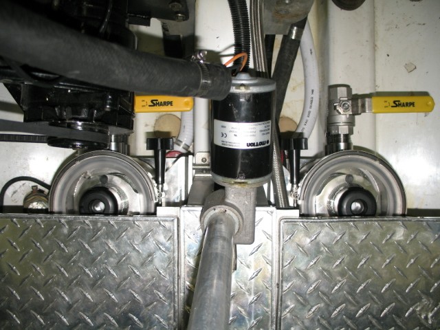

Installed these last time I had an engine out:
Attached Thumbnails Strainers on a 382?-strainers-022.jpg   Strainers on a 382?-strainers-024.jpg   Strainers on a 382?-strainers-026.jpg
LOL! Those photos look familiar! Funny - even though we both sourced our stainless ball valves from McMaster, yours have yello handles, mine white. I wonder if that's because I opted for the locks on mine?
Mine were Trick Marine specials right before the meltdown went down ...
