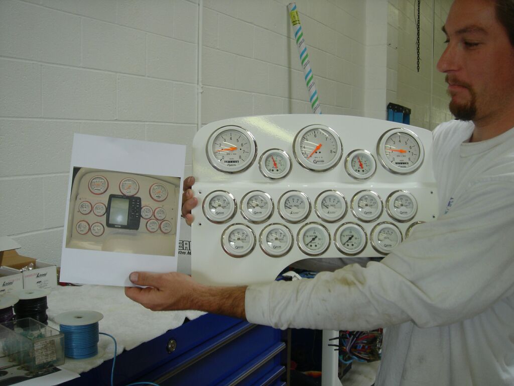

Freshen the the top end while you're at it, replace the head gasket (someone mentioned), and save up for drive upgrades. I have a 2001 and added Whipple 3300s at about 275 hours when freshening the top end. Lots to do......you need gauges so that means a new dash, electronic fuel pumps, and some grinding.
Attached Thumbnails Adding Whipples to HP500EFI in 382-yeah.jpg   Adding Whipples to HP500EFI in 382-dsc00240.jpg   Adding Whipples to HP500EFI in 382-dsc00241.jpg
