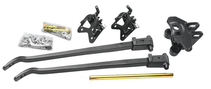

Some info from Reese website very similar to what I use:
http://www.reese-hitches.com/product...nion_Bars,7903
