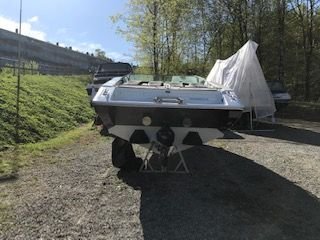

Old 03-28-2019 | 08:11 AM
Joined: Apr 2007
Posts: 533
From: Oslo
Default From Behind
from behind
Mine 280 K are mounted flat to provide chine walk
It was the owner before me, who did this, he had 840 HP engine installed,
He told me that before the 280 K was mounted the 271 started to chine walk arround 70 mph
He did 85 mph with that package :-)
