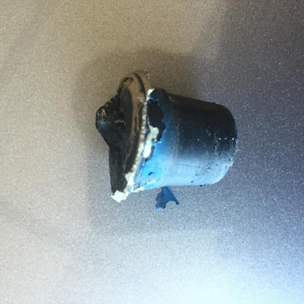

Anyone know what sealant is used on the seals? Thought they would have gone in without any...as you can see, there is something on the one I removed.[ATTACH=CONFIG]556320[/ATTACH][ATTACH=CONFIG]556320[/ATTACH]

Looks like just a touch of 5200.
I put mine in with just a film of grease to help the rubber shift and settle into place
