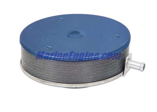

http://www.marineengine.com/parts/im...al/9-31106.jpg
Is this the one that would fit?

Mallory Marine is long gone. What isleft in businesses inventory, if any, is what is left.
I believe Seirra bought out Mallory Marine, not sure, I'll check into that in a few.
Here is the page on Mallory Marine catalog that shows their flame arrestors:
https://issuu.com/marinedirect/docs/mallory/224
And here is the page (next one immediately proceeding above page) that gives the dimensions, throat size, height, width, etc, of the above:

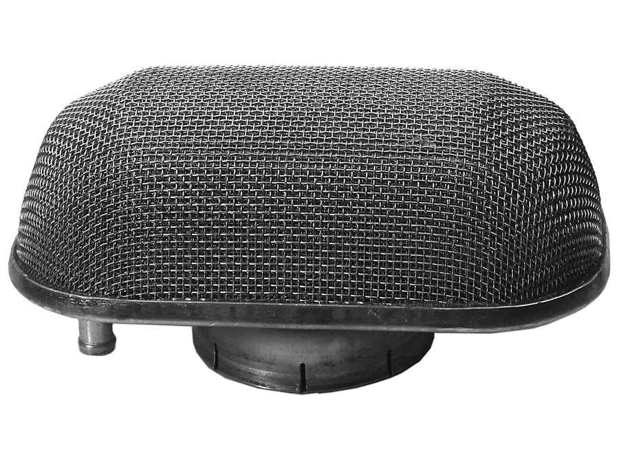

Wouldn't it be great if something like the 496 flame arrestor would clamp on ? I think the flange on it is like 3.750 as far as i could find.
Mercruiser 862537T - Flame Arrestor
Mercruiser 54-863393 - Clamp

Merc has other clamp on flame arrestors too, I'll show them just in case.
As an FYI, I don't know if your engine's throttle body has enough area to clamp something on, but again, ust throwing some stuff out for you to possibly investigate.
Merc 350 / 320EFI Flame Arrestor
Mercruiser #15175
http://www.ebay.com/itm/Mercury-Merc...-/191929629756
