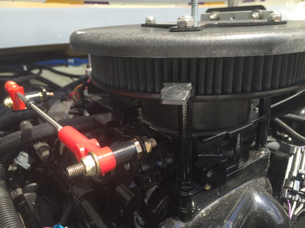

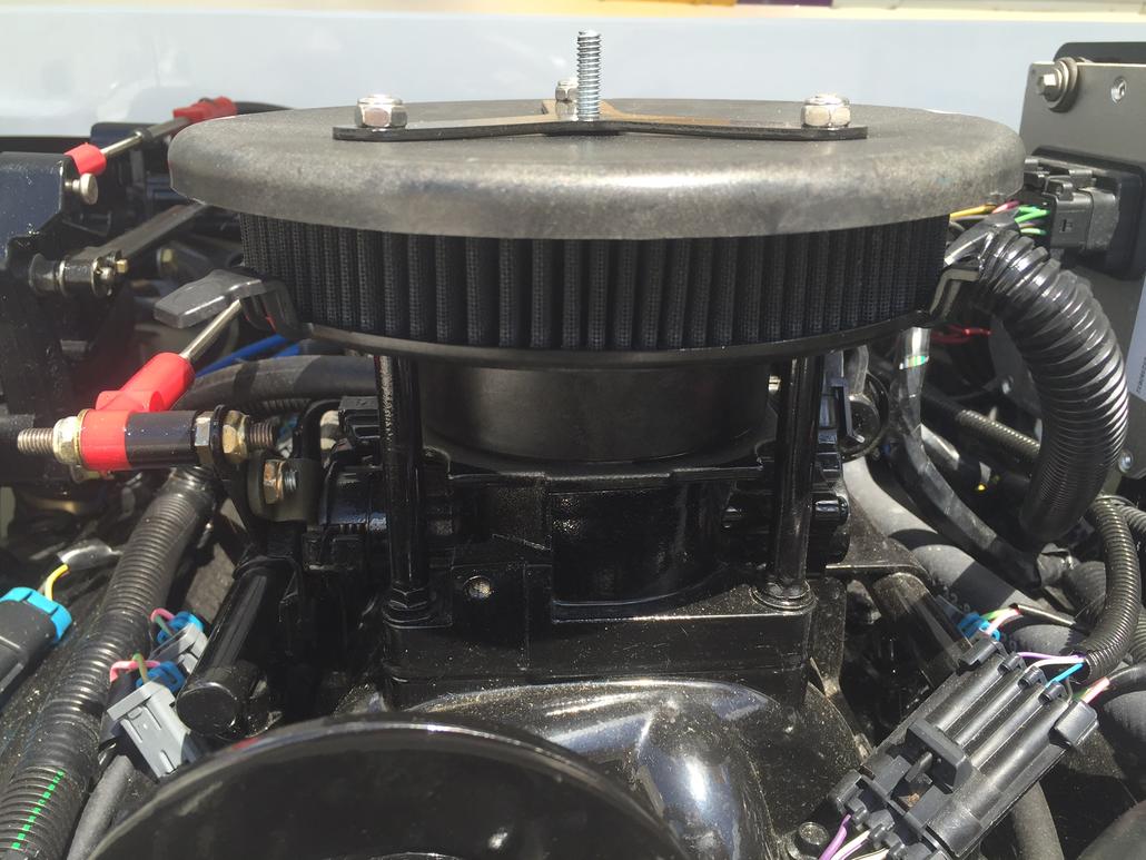

Revspan - Very interesting topic and thanks for sharing your findings so far. I was in our 292 yesterday and took a few pictures of the stock flame arrestor to add to your thread. Does yours look the same?
My engines are 2006 6.2 liter MPI's with no cats. I plan to try and get temperature measurements with hatch closed plus open some and will add to the thread for comparison. Curious, where are you putting the 2X4's for running with the hatch cracked?
I was looking at how the engine compartment is ventilated and mine is the same as you described. Like you said there definitely is room for improvement. I like your idea about ducting cooler air to directly feed close to the flame arrestor.
Good stuff and looking forward to reading how your new flame arrestors work out!

SB - Our flame arrestors are molded plastic and not able to be taken apart and double stacked. Great idea though if we could.
Thanks for all the flame arrestor links and information! There has got to be one in all of these that could be modified and make a major improvement compared to stock.

Dave, those are the same as mine....just imagine a log exchanger in front, cats on either side and hoses to all of it. But, the solution for the arrestor will be the same, as the layout and clearances should be common.
