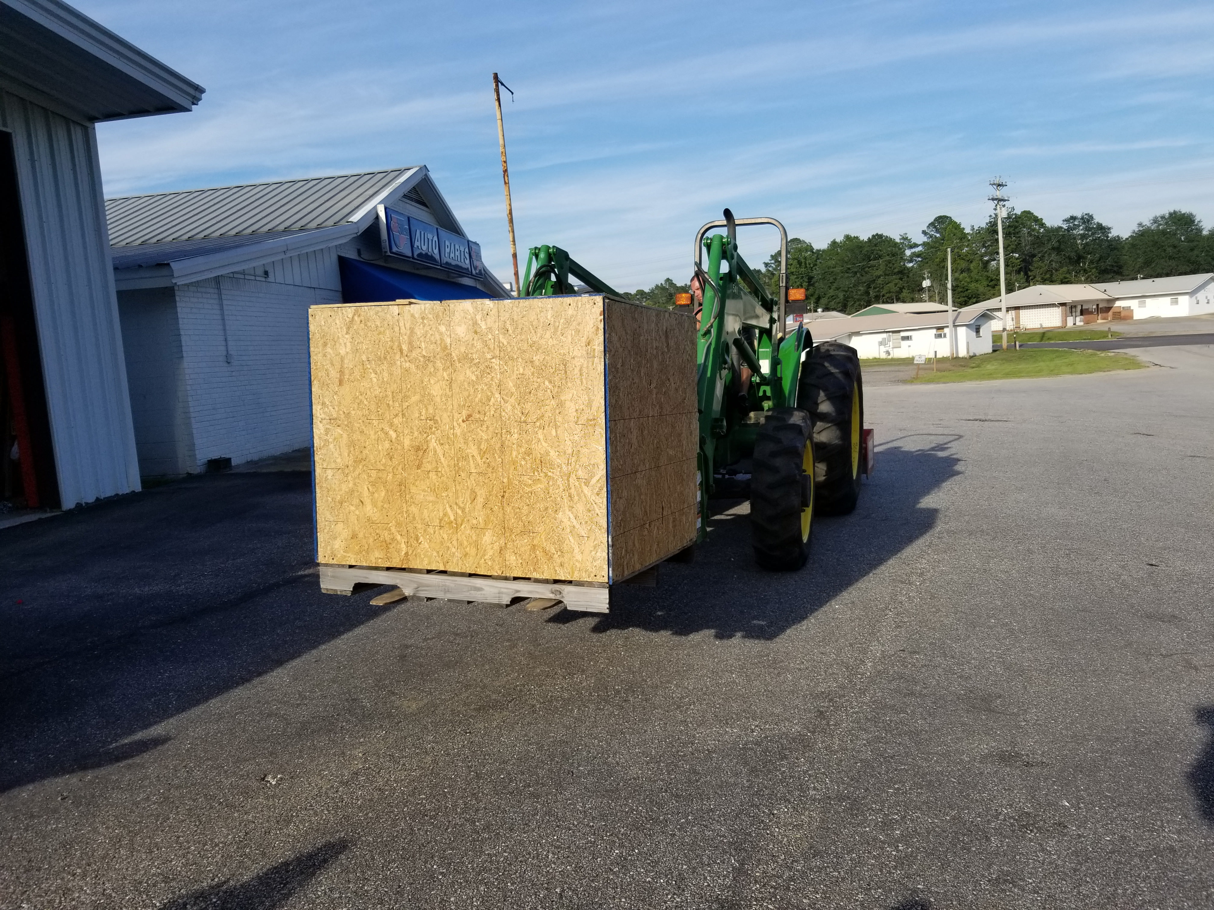

Engine got here yesterday and I took it up to my friends shop.
Got my carb and throttle bracket swapped, most accessory brackets on, harness swapped, headers off. Today I plan to get my exhaust on, new plugs in, prime oil pump and put dizzy back in.

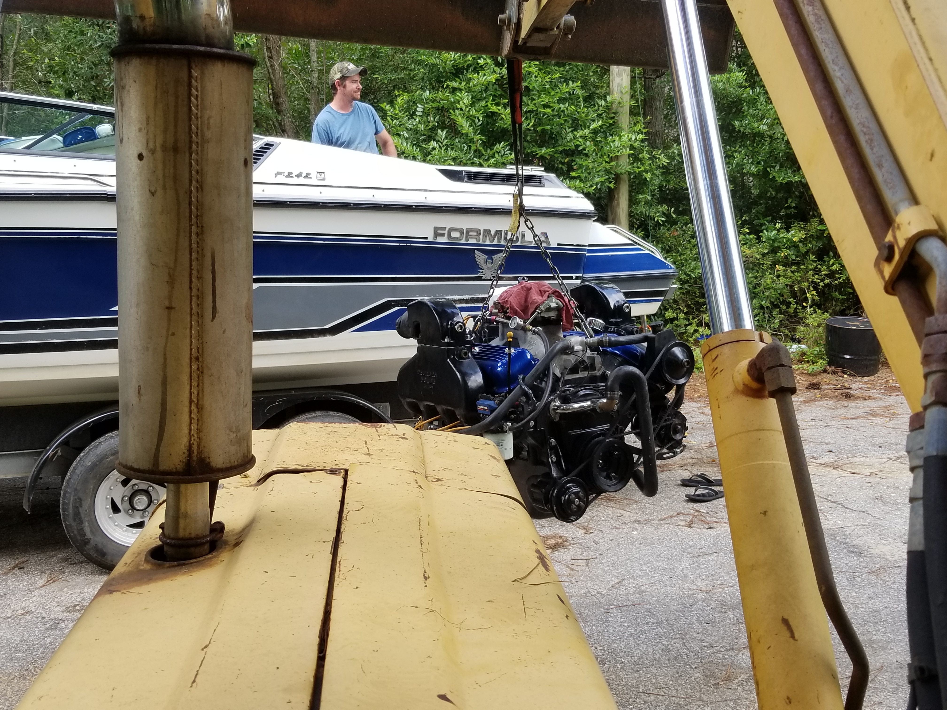

1 Attachment(s)
A little progress. Plugs are in and gapped at.035, heads and manifolds cleaned and on with new felpro steel/composite gaskets, wires connected, ps pump and alt back on, belts go on tomorrow and I plan to take it home and drop in Friday night or sat morning.
Attachment 569772

1 Attachment(s)
She's in her little home. Just dropped in real quick this morning. Plan on finishing up this week in the evenings.
Attachment 569861
