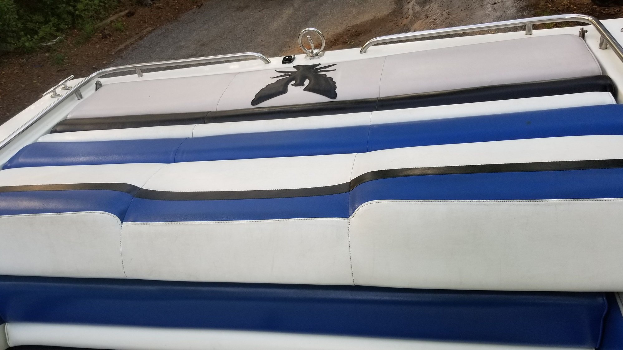

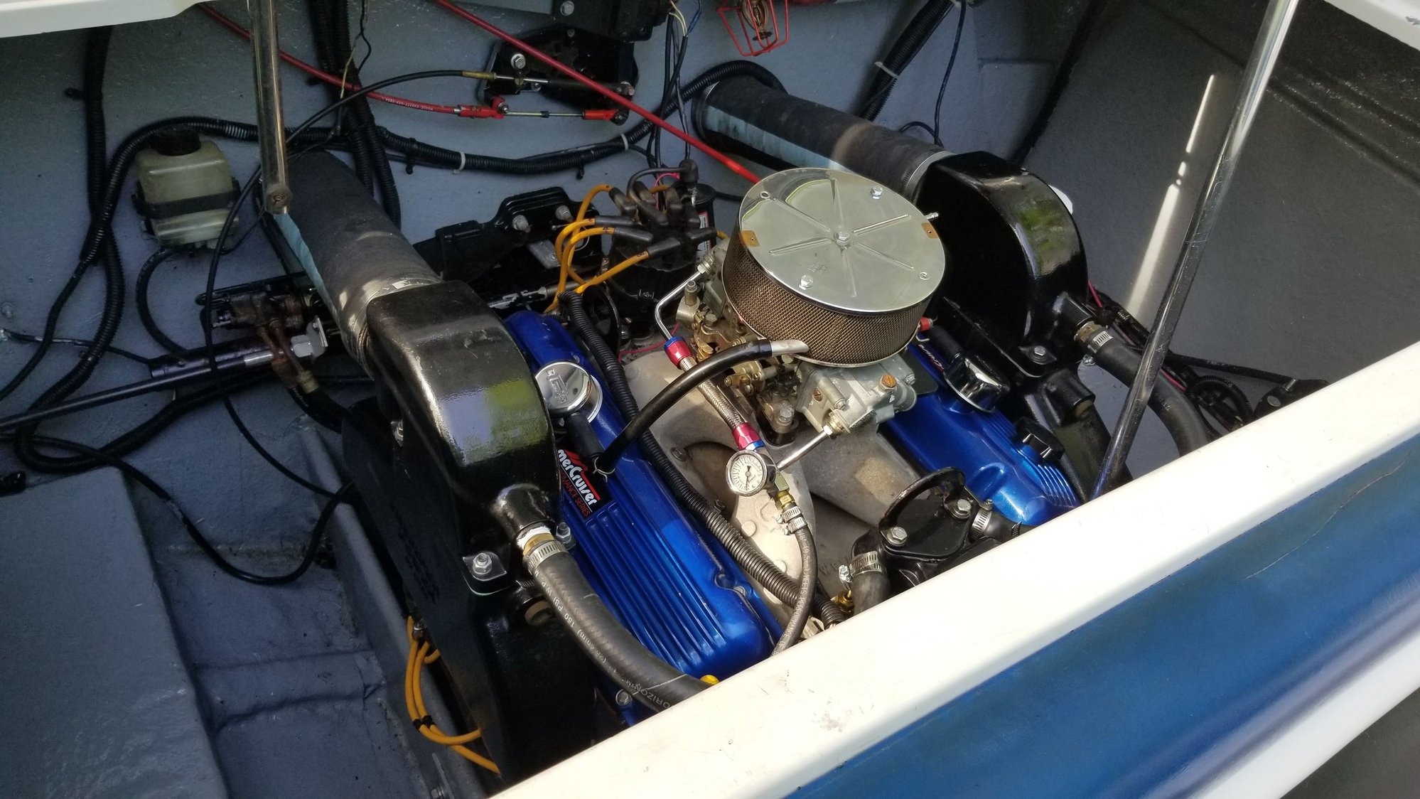

Crying shame I had to wait until May to get it out. But we had a long hard to predict winter. Finally got it out from under the shed today. Drug it to the DMV to register it. Come home and pulled the pollen covered cover back to get to the controls and access the engine. Checked fluids. Put the outdrive in the bucket. Filled it with water and give her a whirl. It fired up and ran well. I dont have my vacuum gauge at home but I adjusted idle mixture by my nose. I'll get the gauge on it Sunday. The last few runs last year idle was a little rich. Got a bit of cleaning ahead of me on the upholstery. I'm disappointed in 3m 303. I put it on 5 layers thick before I covered it. Still got some black spots.

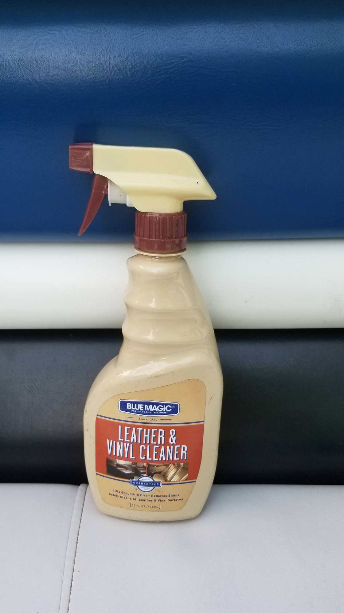

Redneckcustoms13 05-03-2018 07:17 PM
Lasr 2 pictures are before and after using 1 application of the cleaner with a towel. Gonna hit it with a soft bristle brush and get it as good as I can.

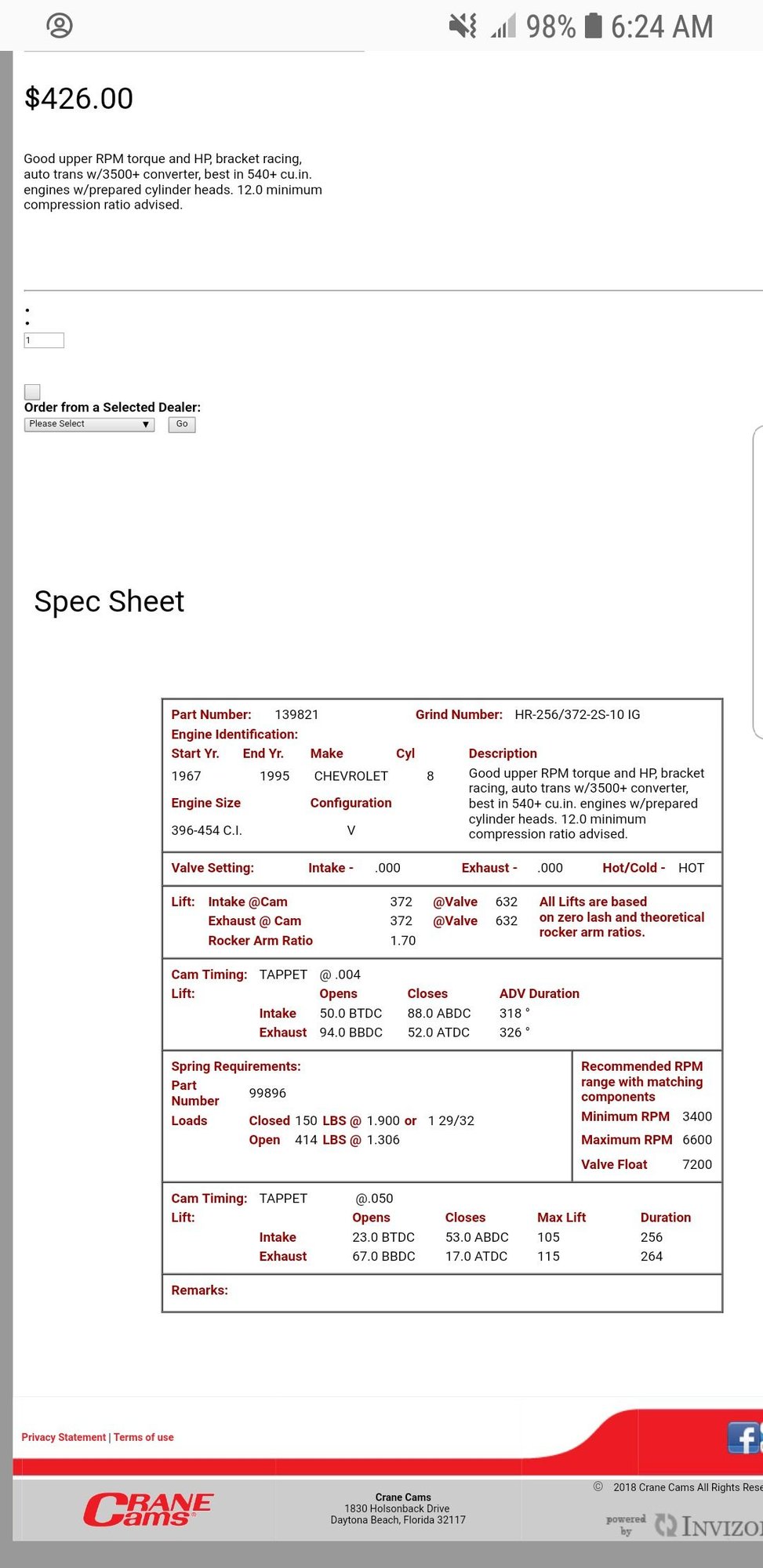

What cam have you got in there Hunter? 5900 is singing!

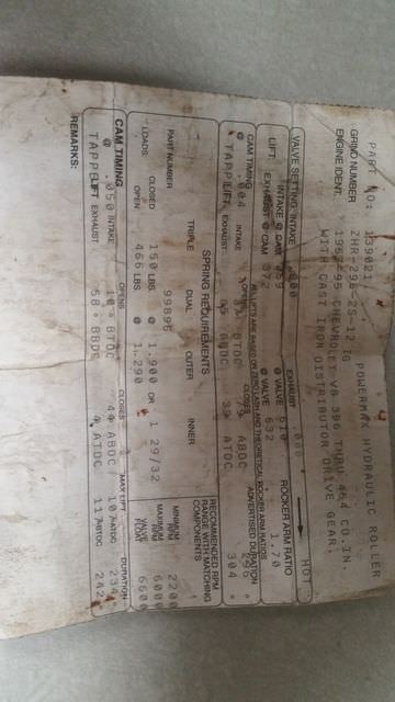

Redneckcustoms13 05-07-2018 04:11 PM
https://cimg3.ibsrv.net/gimg/www.off...5d84a6925e.jpg
More than I'd like to twist but I wanted to try it. I'm thinking a 24 bravo or 25 revo would be good on it. The 22 planes so quickly though.

Redneckcustoms13 05-09-2018 06:27 AM
Tom, this is from cranes website. I'm only at 10.5 compression and 509ci though
