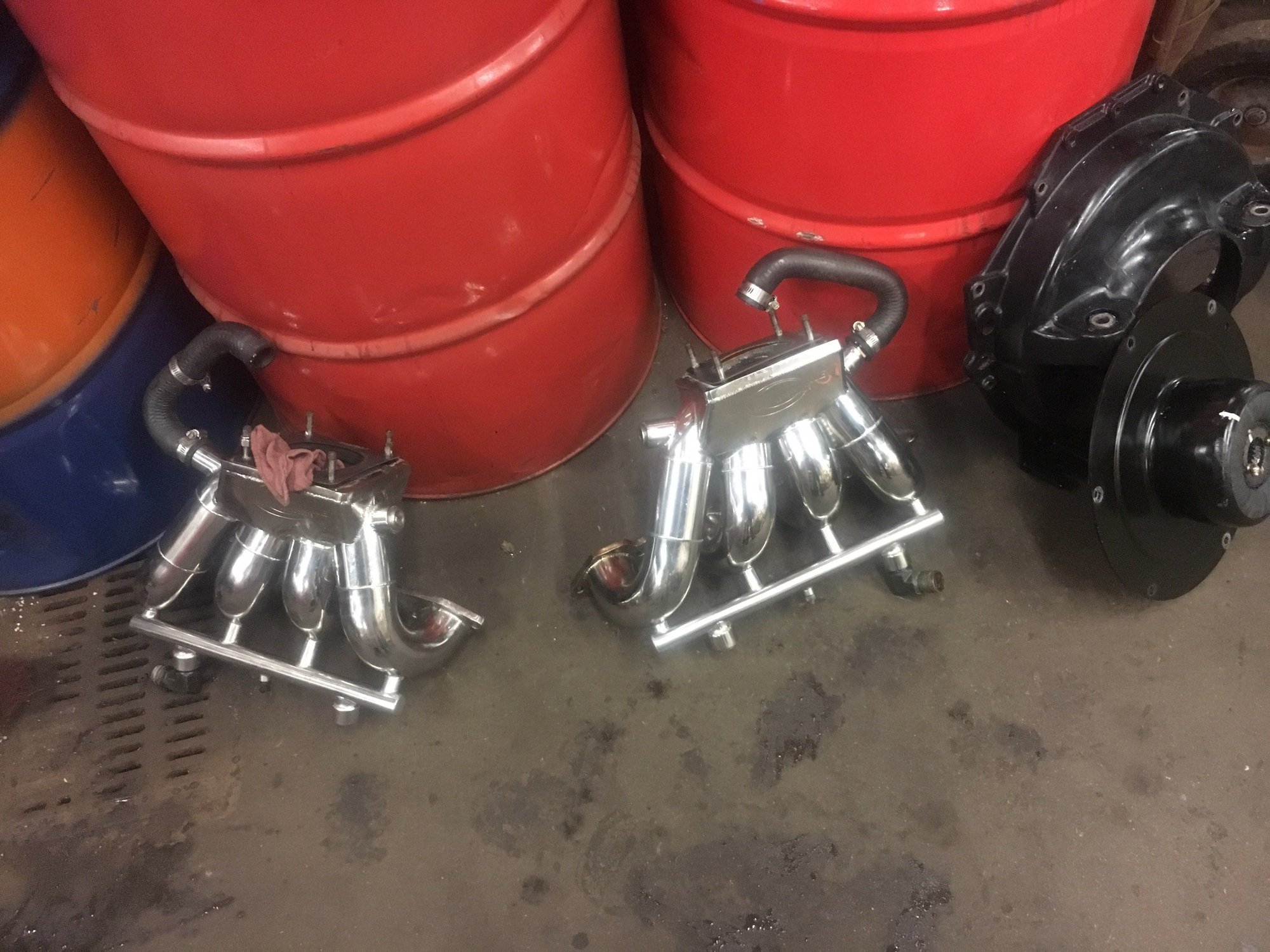

That ended up being a crapped out blade on the raw pump that was partially blocking a port. Been running it this summer. All has been well until this weekend. Going to blue Angel's I noticed it seemed to have a little miss on idle. Got to our destination. Let it cool down. About 2:00 got in the bilge to see if I had possibly left a spark plug boot loose. Nope. All were tight and fully snapped on. Check oil. Had milk. It was fine the night before so whatever happened happened that morning. Got a friend to tow me in. Got home late that night and drained the sludge. Monday drive was off. Yesterday all bolts and hoses off. Will snatch today and get to work on it. Had a suggestion to look at intake gaskets first since I just done riser gaskets 2 weeks ago and know they arent the culprit.

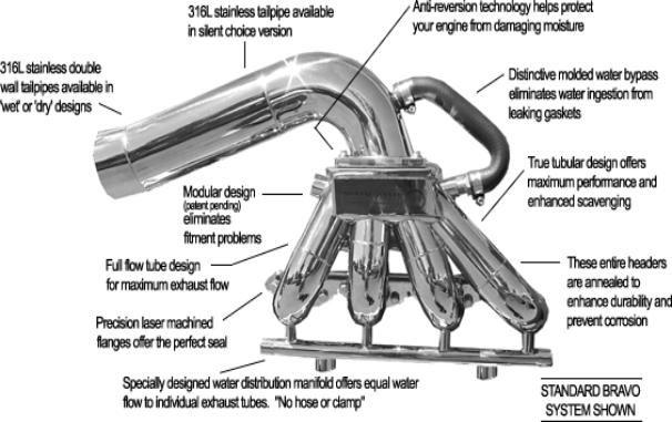

Sick stinger is hooking me up with a great price on some cyclones. They will be going on when it gets installed back in its home.
Dry to the tip. No risk of reversion anymore. Regardless of how low i idle.
The engine they came off of last night.
Got them off.
