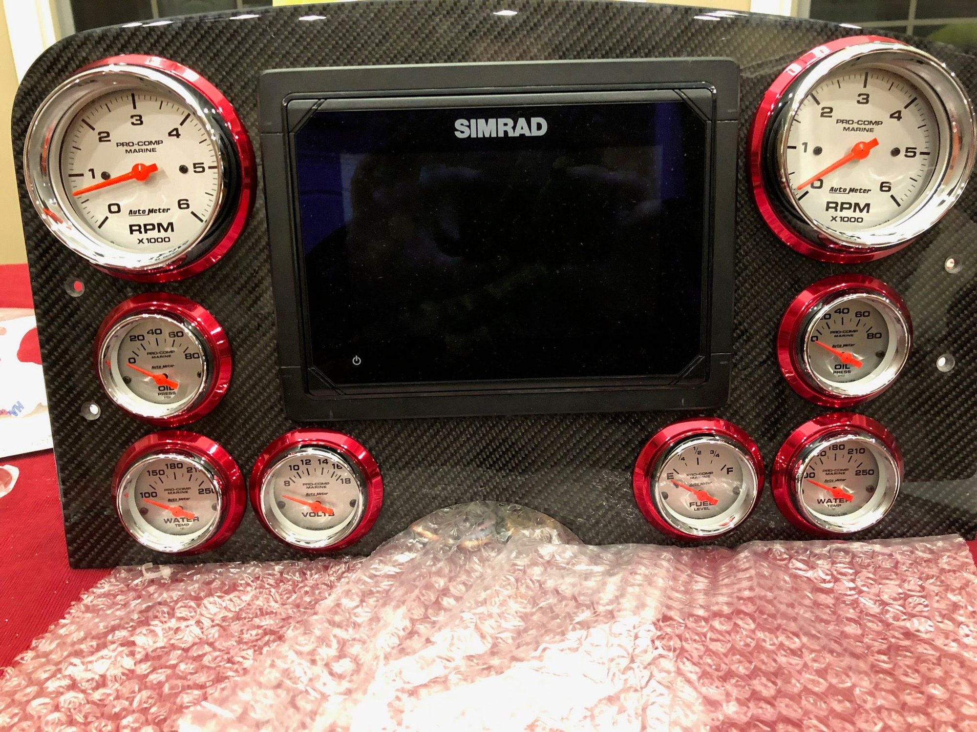

GPS - Mine is permanently mounted on top and sits just below the top of the windshield and across maybe a 1/2 of the gauges. Sorry, no pictures. That said, I really like the job snowrunner did. If I had to do it again, I'd probably go his route.
