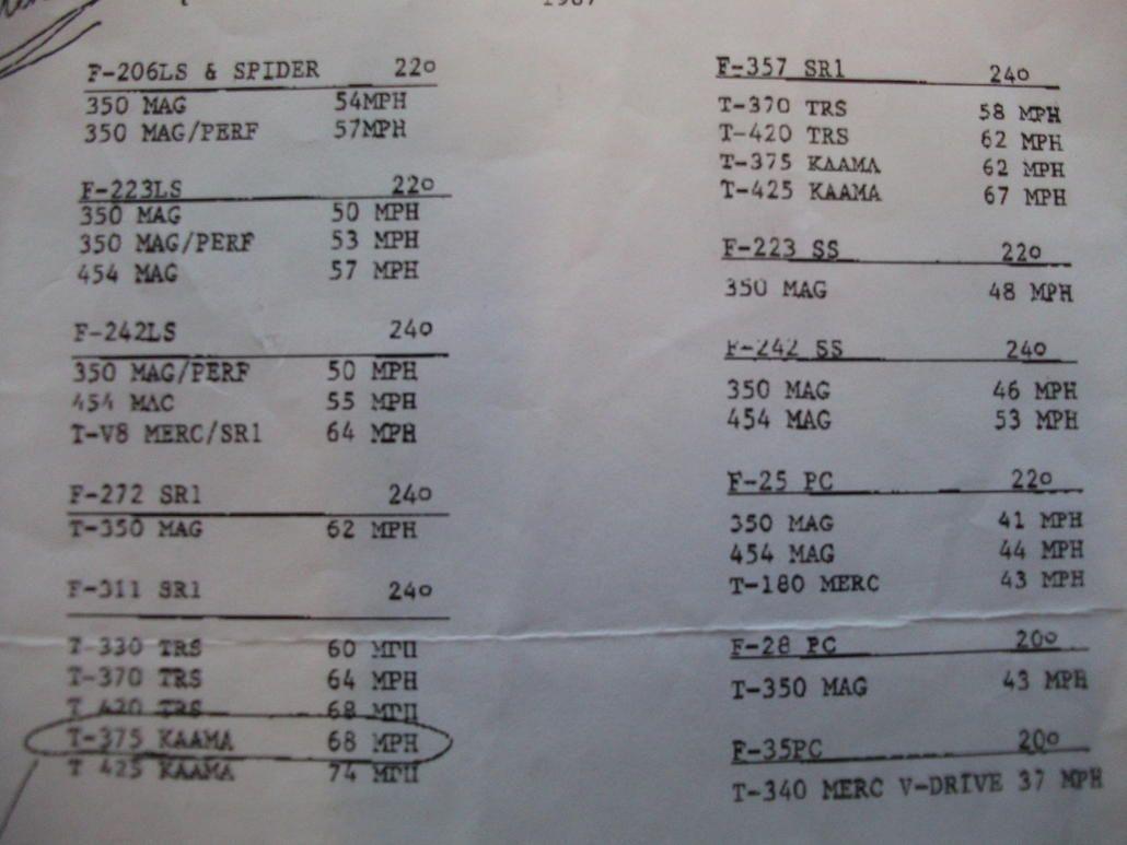

Here is what Formula said
GLENAMY 242SS is offline

Exhaust tip location might be off. If using stock exhaust with long hoses, that won’t be an issue. But if you use aftermarket exhaust it could create some problems with exhaust tip alignment.
454... a stock non-mag 330 engine is going to give you low 50’s, high 40’s dependent on load. The 365 mag will get you around 55. If you have a mag, then you have a good foundation to build from.

It's not a mag. If it was low 50's that would be gaining me 10mph. How much heavier is the BB/B1? I like how the boat sets in the water with the SB
