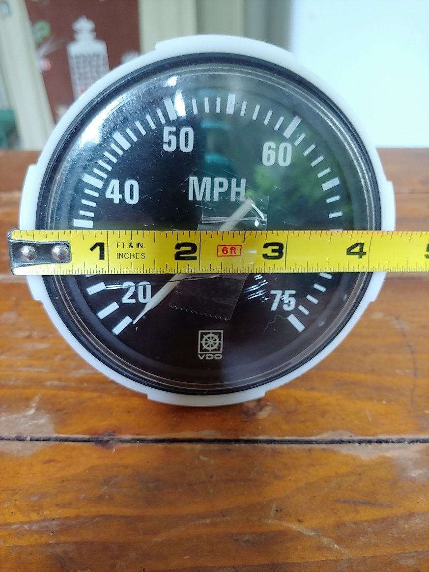

Turns out my speedometer face is 4" in diameter and overall 4.5"...what size do I need? The 85mm was too small :-(https://cimg0.ibsrv.net/gimg/www.off...7c8f60e30f.jpg

How does this mount in the 3 13/16 mounting hole in the mounting plate on the dash (1988 F311)? The description says "Gauge size: 4" (3 3/8)" but I already tried an 85-87 mm gauge (which my math said would be right at 3 3/8") and it was too small for the opening.

That part # description says 5"...see above post (about the size opening I have), does this fit without modifications?

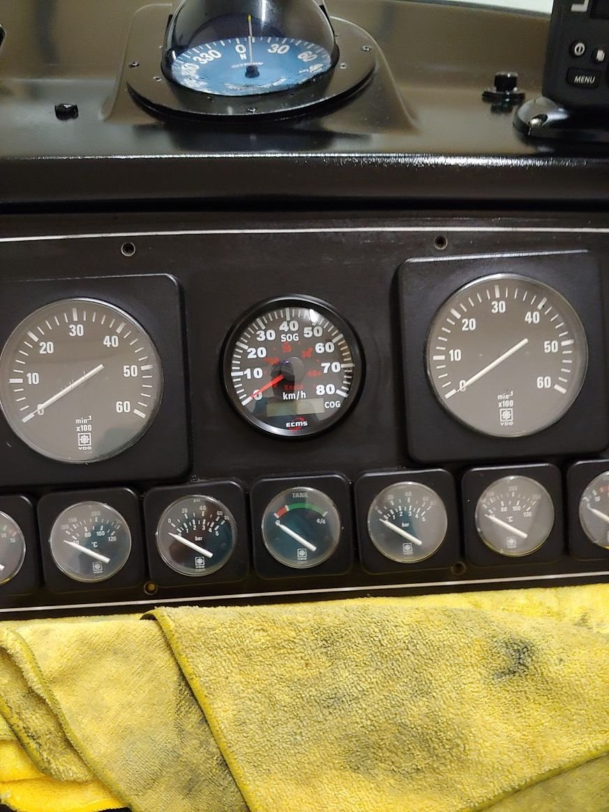

Please forgive me...I have been focused on the trim plate and not on the actual hole in the dash. As you can see in the attached picture, the 3 3/8" (85mm) gauge fits the hole (but not the trim plate. Therefore, for very little money I can have a GPS speedometer...until I decide that I want to pay 5x more for a bigger one, or switch out the tachs (or all the gauges).
Thanks for putting up with me!
Tomhttps://cimg9.ibsrv.net/gimg/www.off...14759eba47.jpg
