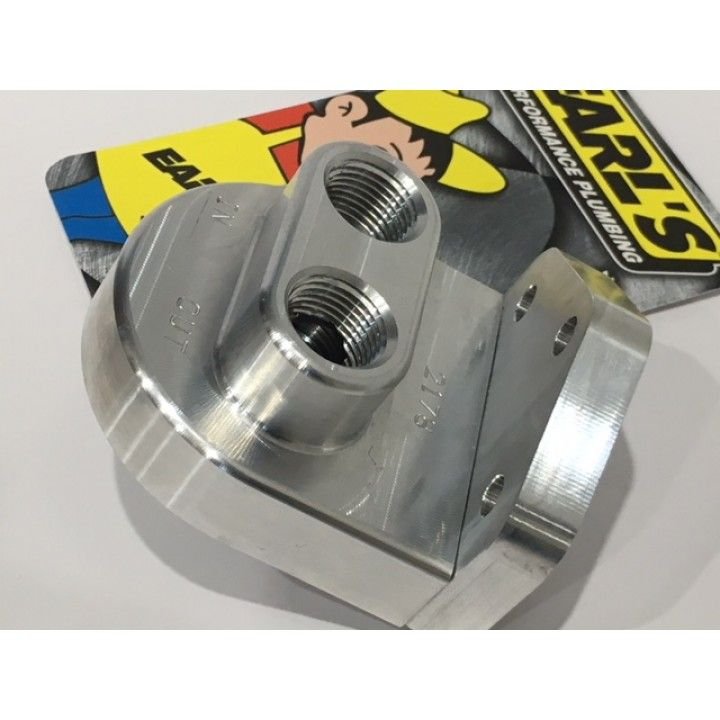

If I get some time, I’ll wrap up oil hardware and lines today. I’m lopping off the horizontal shelf where the old filter head mounted. The HP1 head will be bolted to the vertical edge of the bracket, nice and compact. It’ll still be upside down, but I like the presentation and it’s not bad removing the filter if you break the seal just a touch and let it drain back.
