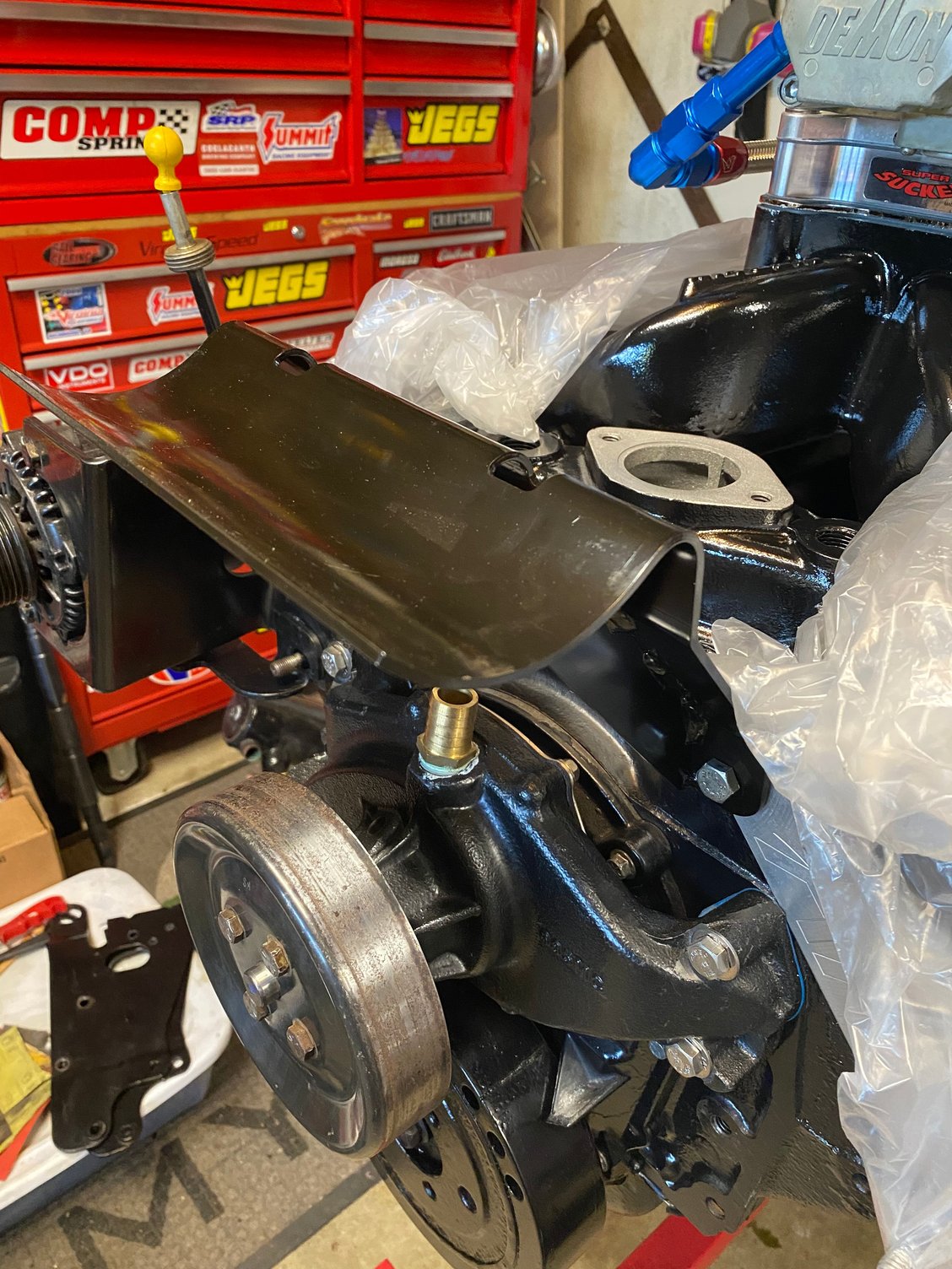

Scraping and painting!!
Because my heads were seeping, some brackets really took a beating. I'm reusing the cool fuel bracket to support my Holley pump> Last night we sanded the heck out them, then washed and wiped them down with solvent to paint. We painted with an oil-based satin black Rustoleum and they came out "okay." They'll be in bilge-land so I'm no worried about appearance... just need them to not rot away so I think we accomplished that mission. They were wasted!
The fuel filter heads were also in really bad shape. Same treatment - these came out much better. Still, they'll be hidden, but the work will make them last.
These pieces are ready for regular paint. I had some chipped areas that needed help so I took care of them, and if I manage not to drink my face off (serious girlfriend issues right now), I'll paint tonight.
This is my heat exchanger bracket. I got all the right bolts, spacers, bracket and felts for $270 for both engines. Merc wanted $377 per bracket - that's right - per bracket. I got them from Performance Products Technologies out of Oklahoma. It took a little time for delivery, but everything made it with no issues and the parts were on the money. Their prices aren't all deeply discounted, but I've had great luck so far. Still waiting for my ARP water pump bolts.
Aside from painting, I might work on the rest of the fuel plumbing tonight. My USCG Push-Lock hose came in today. It's time to put all the fittings I've bought to use!
And today was another $500 parts ordering day.

In pic above... you’ll notice the crank pulley is still off. I have a brand new pulley that’s waiting on clean bolts for the install.
A lot of this stuff will need to come back off to go back in the boat. The transmissions make it tight going in and out. To go on the dyno, they need to be dressed.
