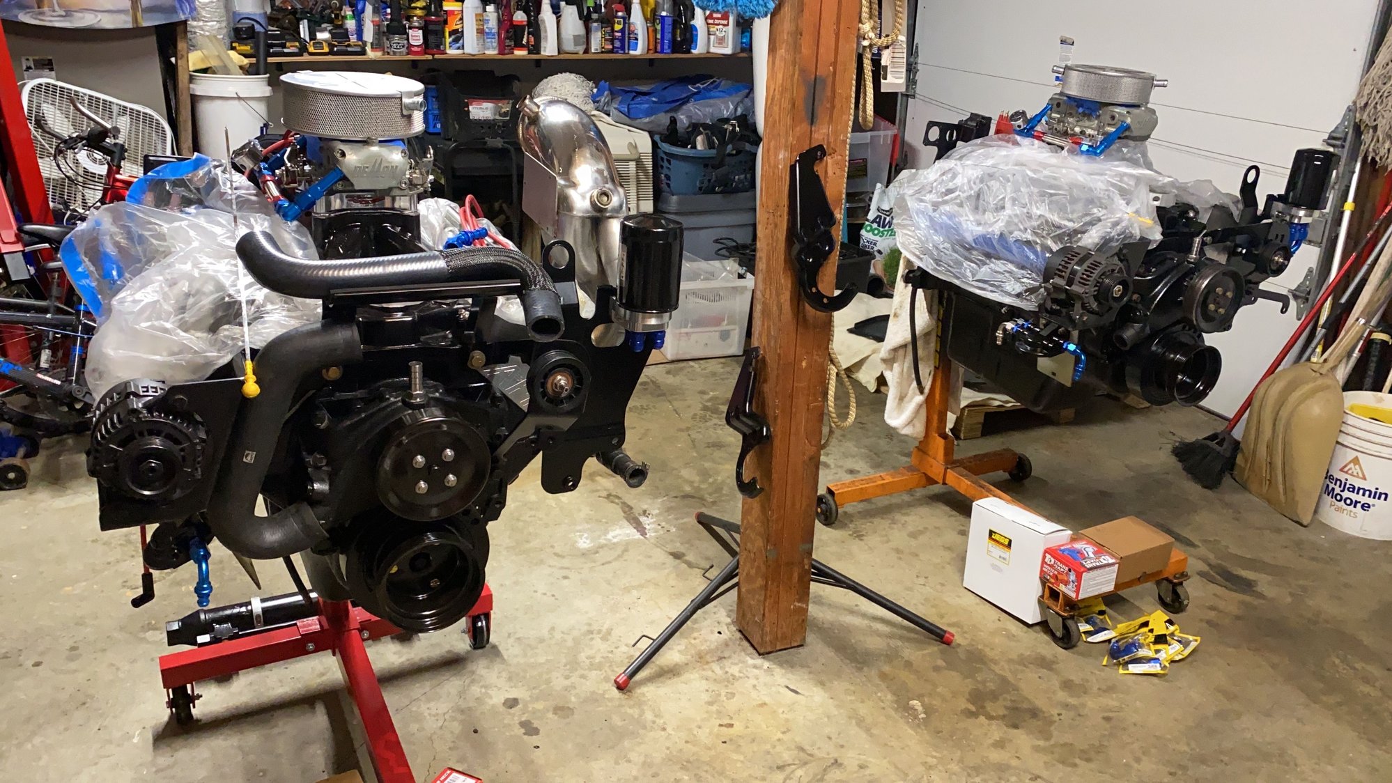

I spent most of today working on the Cigarette with the guys. We’re close there. Some hoses, shoring up some rigging, and drive/throttle cables. Probably firing later this week or weekend.
Tomorrow (or tonight if I get really bored) the engines come the stands and will be put on the engine mounts so I can mock up the plumbing with the everything attached. The engines are filled with break-in oil and ready to be primed. Really really close now.
Yesterday’s view...
The starboard engine was covered up because I was going to cut some aluminum for brackets.
