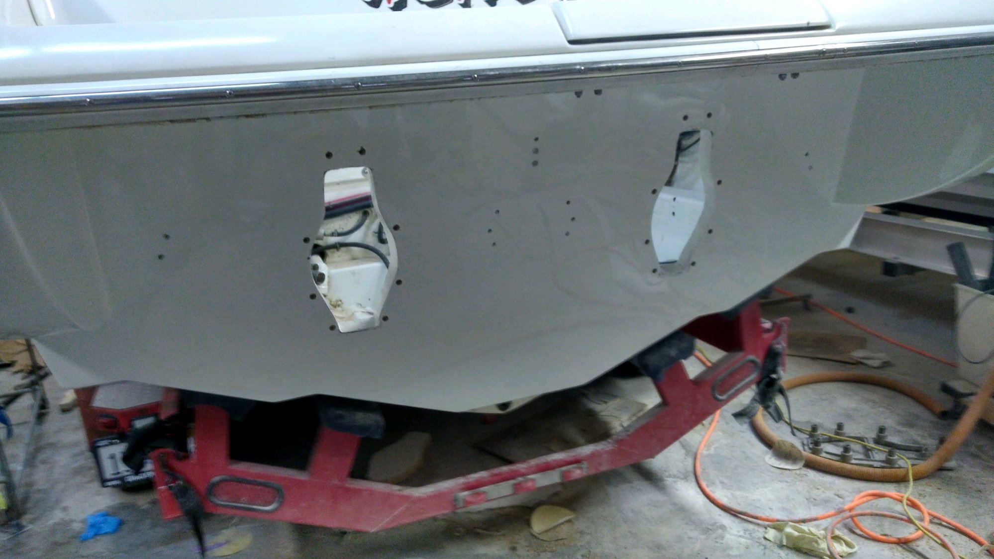

Originally Posted by AllDodge
Don't see being able to do the exhaust as sketched and still have outdrives. If you installed transmissions then it would work
Nice work so far
Just throwing some ideas around, I won't know exactly what i can do until i have the engines back in the boat. Maybe not something that extreme but the tips slightly closer together on the transom would look cool. Just figured I'd make it unique since i have a blank canvas.

I would stick with stock exhaust...what happens if it needs to be replaced down the road. Cost an arm and a leg...next buyer might not be so thrilled with your decision.
Already have IMCO powerflow manifolds with 14 inch stainless tails that i ran last 2 seasons.. stock exhaust went to the scrap yard. The stock exhaust and silent thunder is the reason I had to replace the transom in the first place since it leaked at the tips.

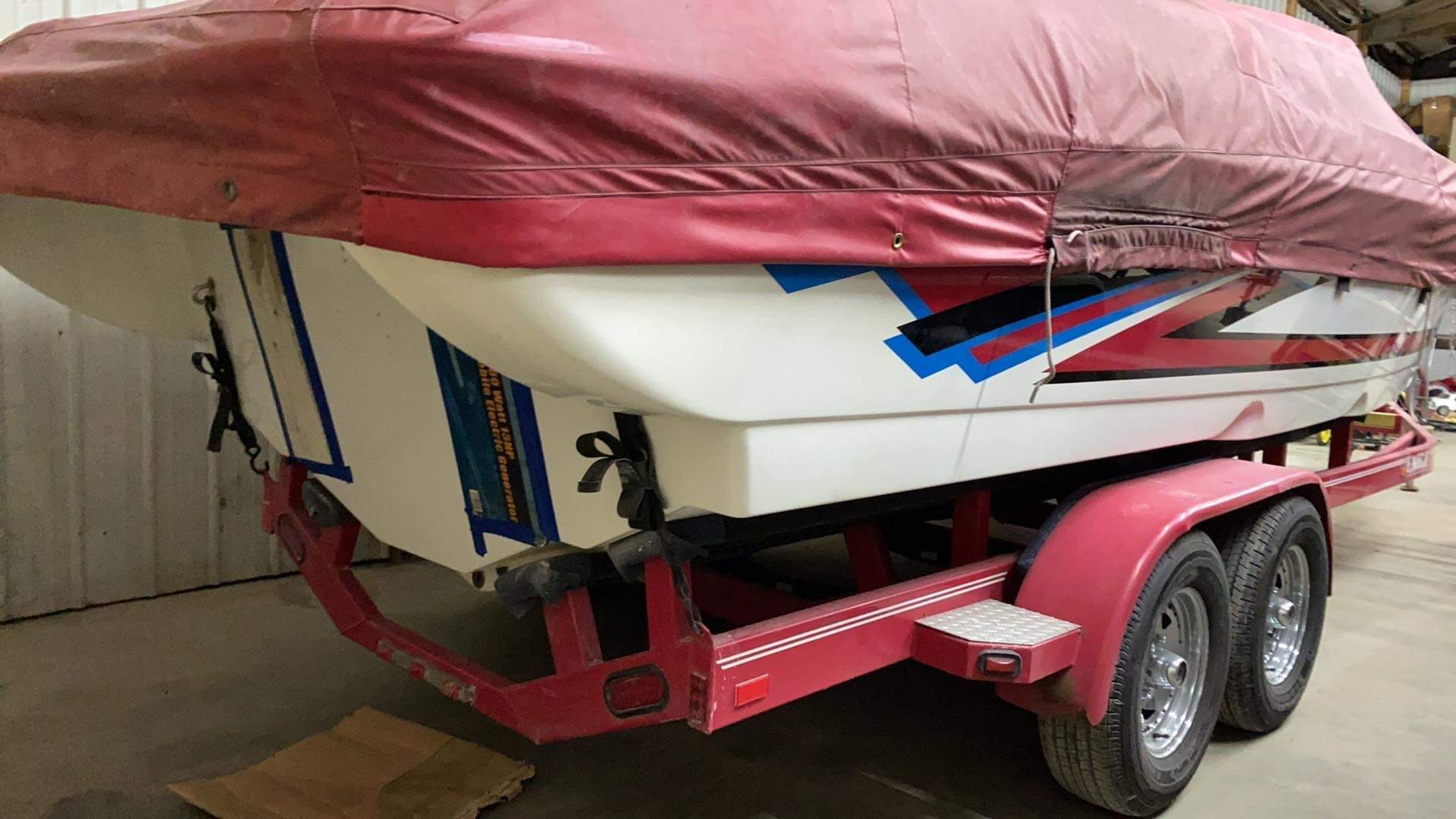

Dave finished her up. I am beyond excited! Picking her up next weekend

Hope everyone is doing well, got HEAD RUSH back a few weeks ago. Shes Currently sitting in a heated barn waiting for me to put her back together. Been busy enjoying my snowmobile. Gotta bring my tools down there and get to work!

Originally Posted by Alwhite00
Looks great, it will be better than new. What’s the $$$ of something like that?
I did all the De-rigging myself, it was around $6k for the transom replacement. Still putting another $10k into the boat in New parts and maintenance.
