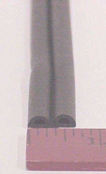

Old 07-01-2021 | 04:26 PM
Joined: Oct 2017
Posts: 125
Likes: 12
Does anyone know if this is what the windshield gasket looks like? I guess this is what formula uses currently. I haven’t pulled my boat apart. Was hoping to order what I need then take apart to replace so it’s a reasonably quick fix as boating season is here. Thank you
