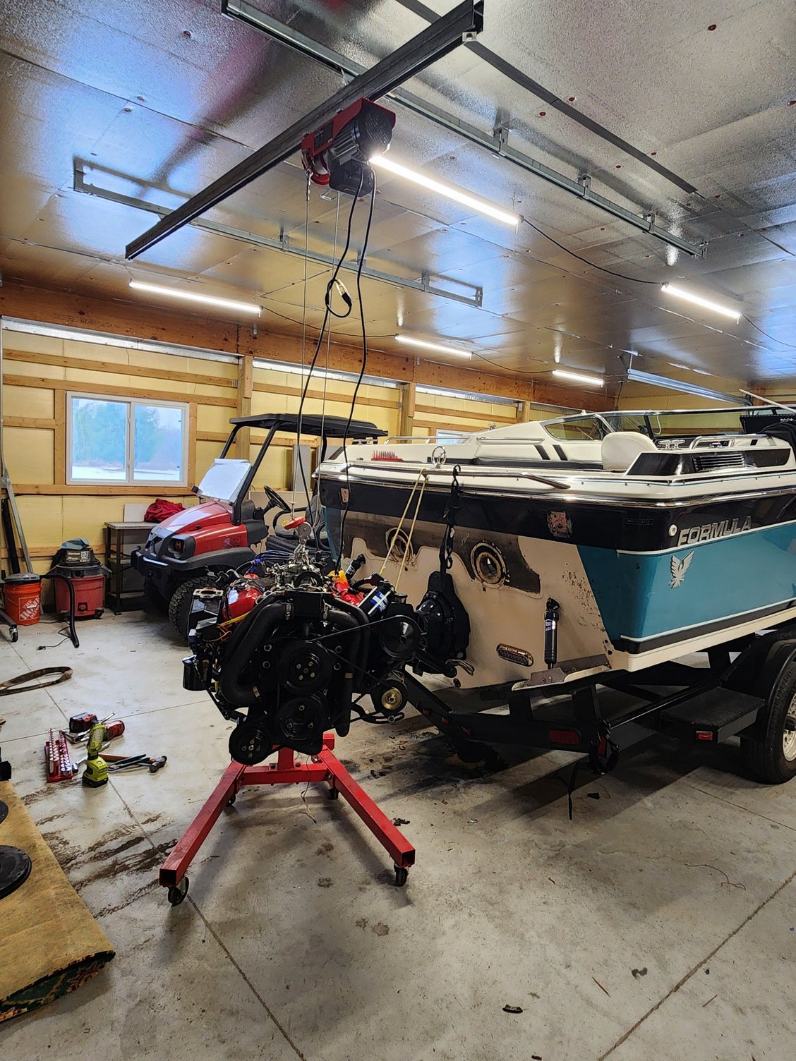

Default 242 ST Platform Removal

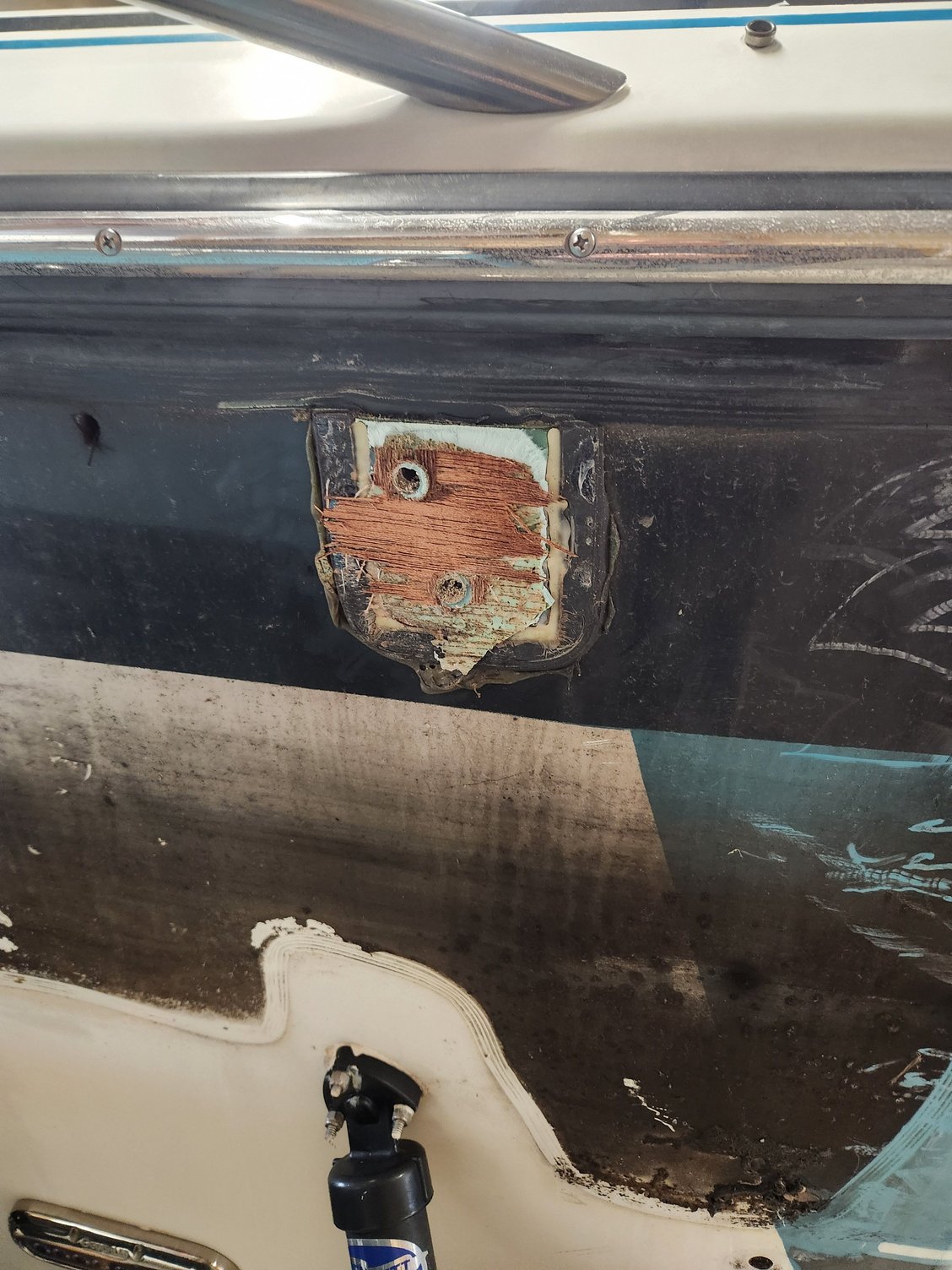

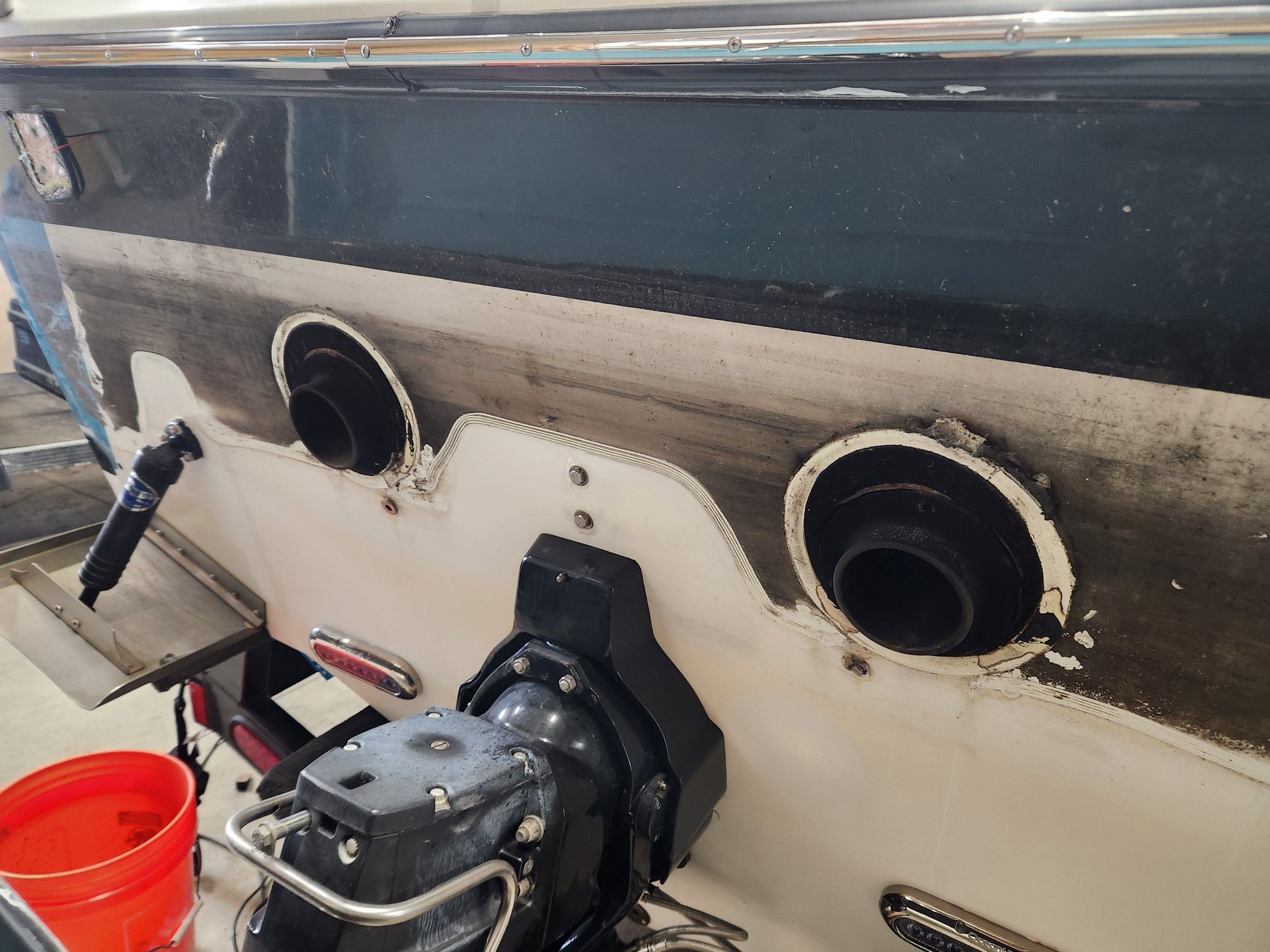

Finally got around to pulling my ST Platform. It did not want to come off!  I had to cut the upper u bolts and hammer wedges in to seperate it from the hull.
What ever adhesive Formula used bonded the fiberglass well. Ended up peeling the outer layer off the hull and platform.
No damage from water on transom as the gaskets were in good shape. Some soft spots at lower U-Bolts and Exhaust openings. Now contemplating a new transom...Only had a couple soft spots when I had stringers done a few years ago. I'd like to get rid of underwater lights, clean up some bilge wiring, add Hyd steering, and some 280 tabs now its all apart, but I know how **** snowballs :/
Engine out. Planning to add new heads, roller cam/ rockers, exhaust, intake, & carb. Shooting for 450-500 HP. Should get me to low 60's 🤞Best top speed with current 330 HP is low 50's. Maybe wait to do transom and steering down the road. At least the trolley and Harbor Freight hoist I installed worked great 👍
