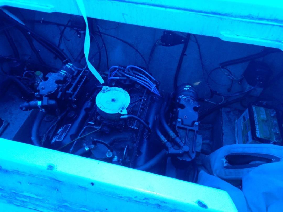

Upon looking at pic, it looks as if you may not have the Silent Thunder……I don’t see the rectangular holes that the exhaust exits out of. Look in the engine compartment and see if the exhaust goes straight out the transom or if you have a “y” pipe for the exhaust to go out below the waterline. My transom was damaged from the exhaust leaking out of my platform and you may not have that problem to worry about. Also looking at pic it seems you do have a bravo one outdrive. It will be a great drive for your power and setup.

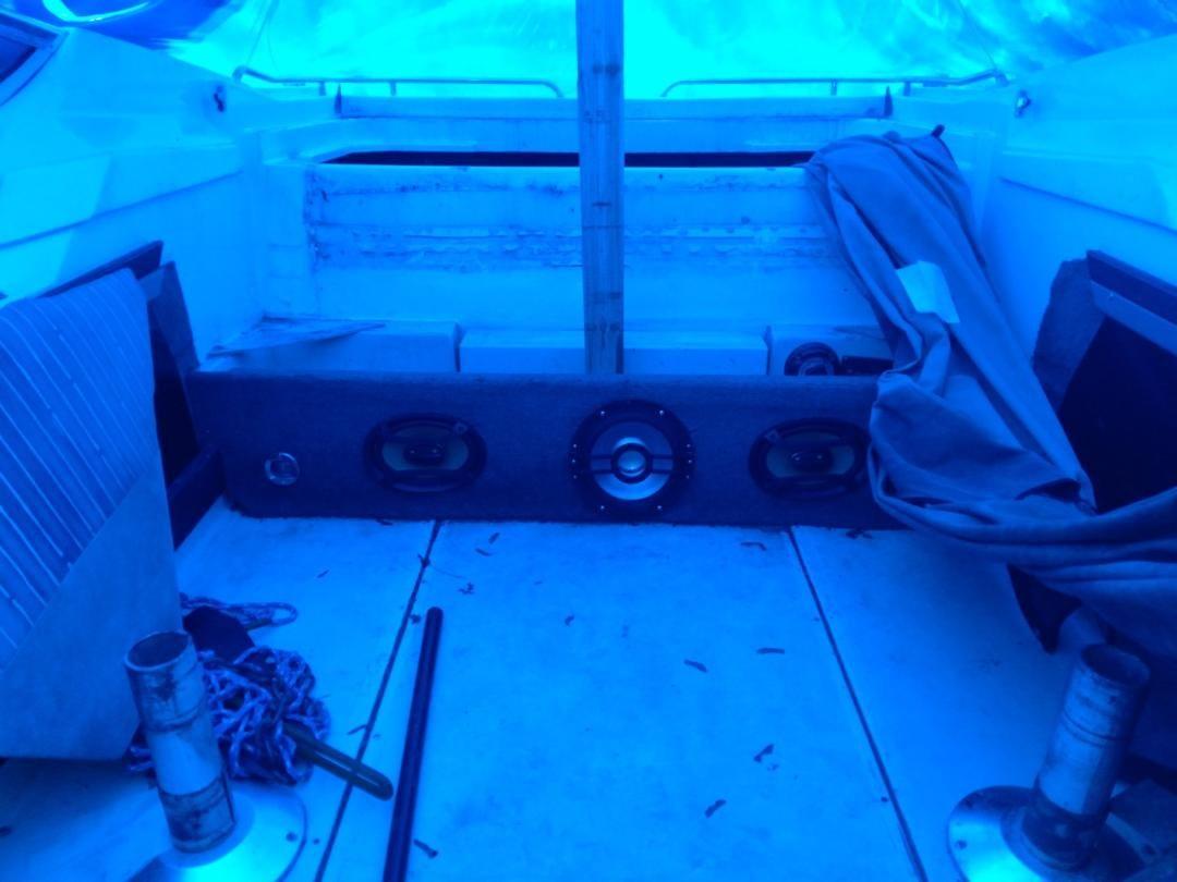

Each side of my exhaust goes down and both curve to meet in the middle at the bottom of the transom. So, no Silent Thunder rot worries? Looking outside at the back I am wondering where it comes out? Apologies for the blue tint in the photos. Under the winter cover.

So it looks like it is a standard thru-the-prop exhaust...which is fine...you just won't hear that big block rumble, which some actually like. There's a clean slate there to work with insofar as the interior goes, you can make a nice example of a vintage boat if done right. To me, THAT is one of the coolest things, to have an older boat that makes people go, "Whoa! It's how old? No way!"

My ST platform rotted and allowed exhaust to get trapped between boat and transom which damaged transom requiring repair......you’ve probably seen my current thread on repairing that. Yours shouldn’t have any water to rot it out and for sure no exhaust to do any damage.
