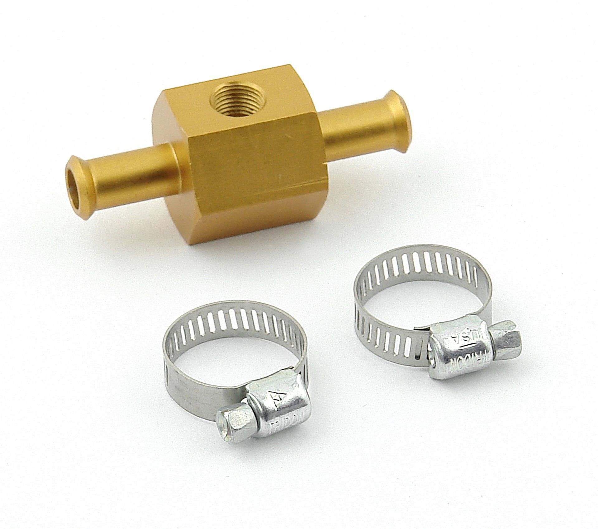

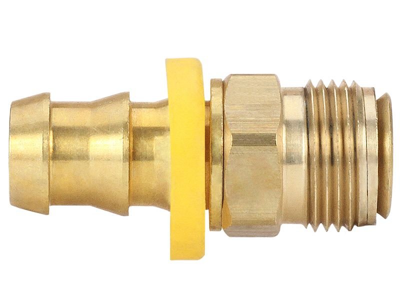

Originally Posted by racinjason15
Oem, hei distributer, top end has maybe 5 hours, i had the heads machined, valvejob, all new topend. Im goin to have to get a gauge and check fuel pressure… whats the best way with the hardline set up to the carb?
so…thunderbolt iv or v ?
I have flared to nipple fittings and use rubber line for the test. So, undo steel line and install that. 3/8” inverted flare (mine are swivel) by 3/8” id hose bard fits many fittings on mech fuel pumps and fittings on inlet of carb. Obviously get a 3/8” hose fuel psi gauge adapter and 1/8” npt psi gauge.
That’s how my set up is, surely other ways.
