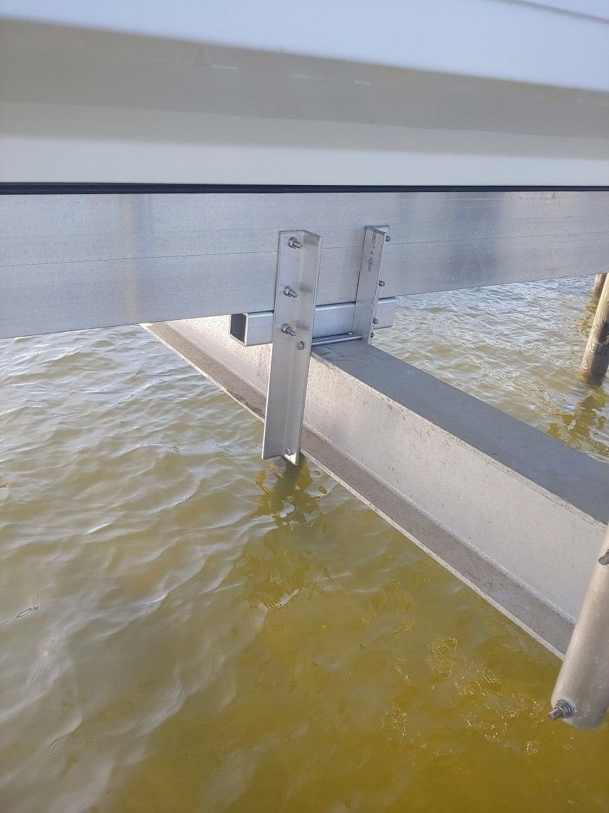

Originally Posted by hogie roll
I’d do it this way. I went with 12” bunks because my hull has a funny bottom feature that pushes them apart on width. With the steep dead rise in the front it was sitting on the crossbeam when I had regular 8” bunks.
You can avoid this by going narrower if the hull doesn’t have any strakes that prevent it. I also prefer the 12” beam for stiffness. It’s a bear though, I think mine weighed 250lbs
I had ~2" spacers added to my bunks because I did not want to move them any narrower and the keel was going to hit the crossmember.
