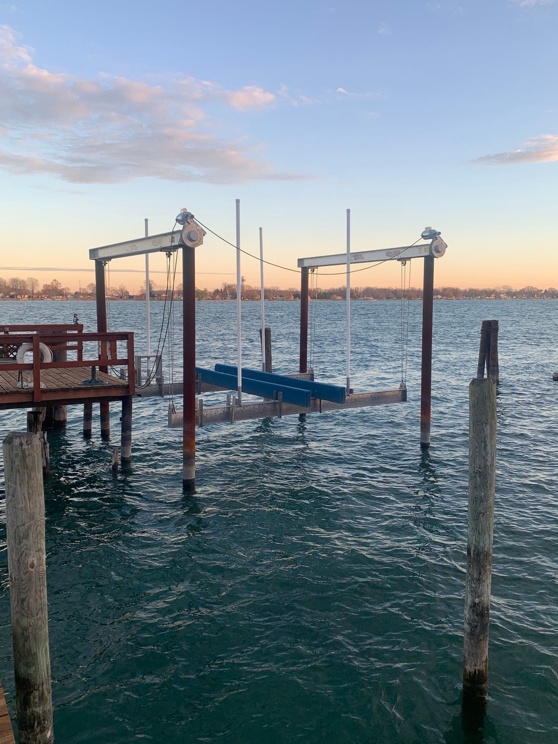

Hello, Looking for information proper support on our boat lift. I have a #20000 lift. It has 16 X 12" X 4" oak bunks that are straight.
Need info on:
1. span: distance between bunks? (inside distance)
2. support at steps 1.5 "
3. Angle of bunks (needed?)

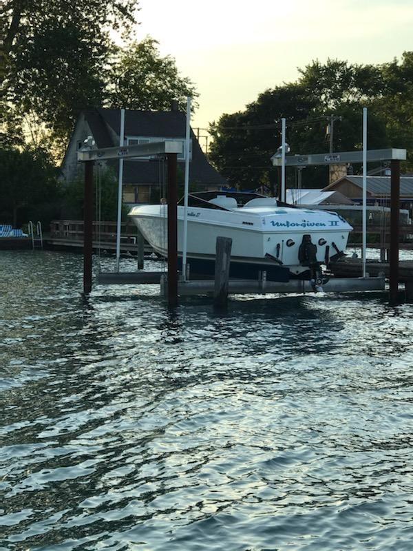

This is my 27 that was on it last season.

Yes thank you. I called them and they were very helpful. However, I really don’t want to spend $10K on a custom cradle. Looking for any information on using or modifying my current set-up of 16
foot beams. Any past experience or pictures would be helpful. Thanks in advance!
