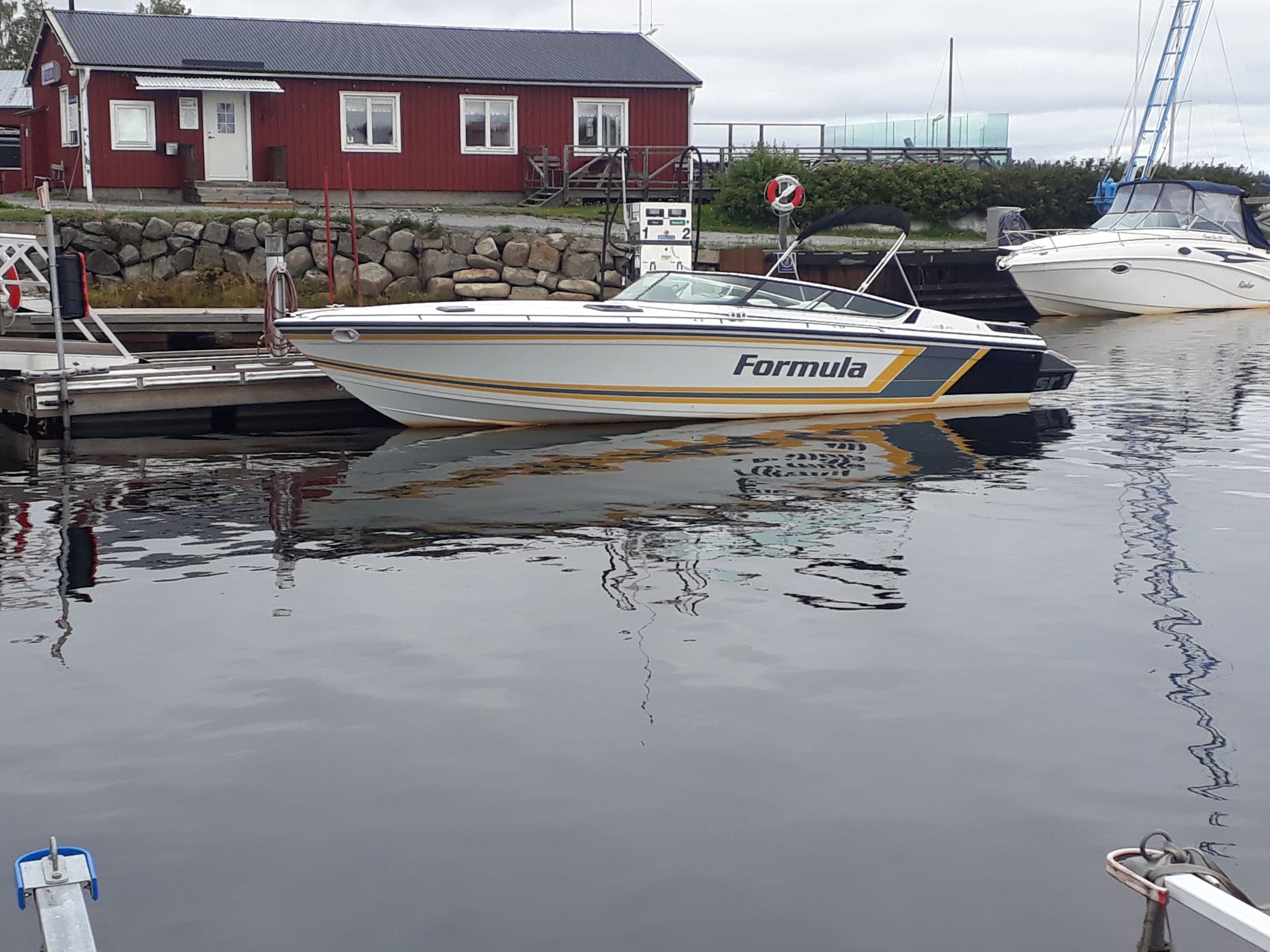

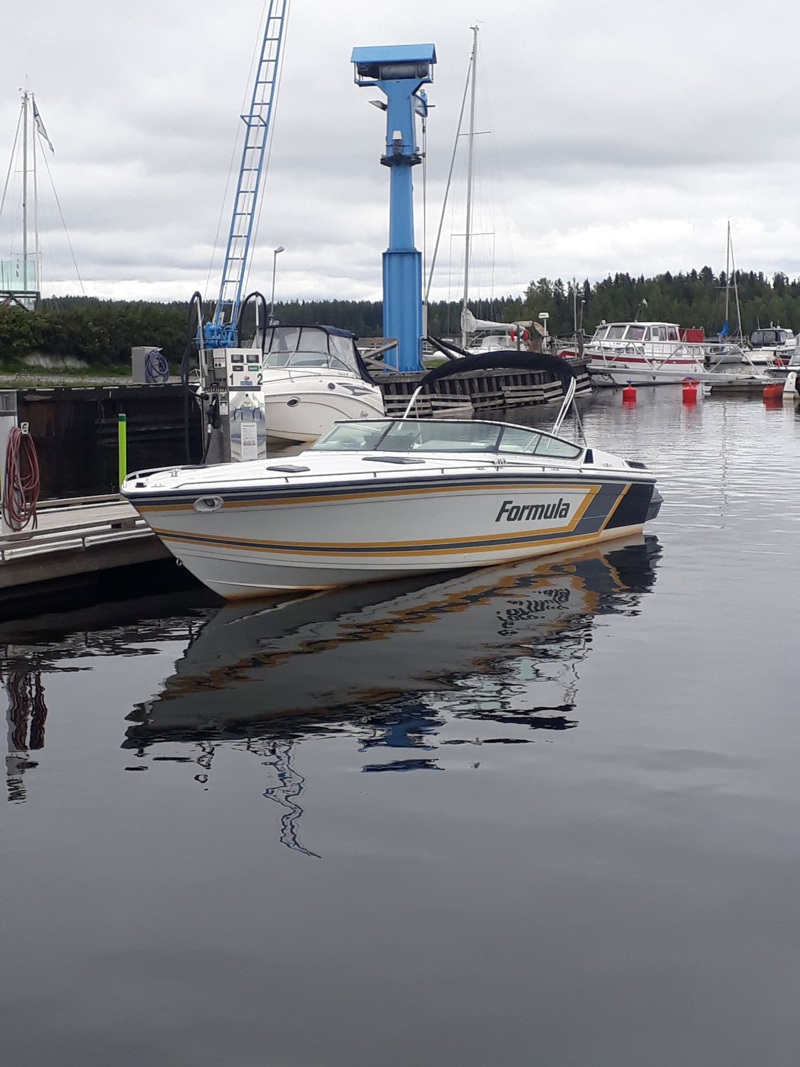

Originally Posted by Scarab Viking
100% Sure:
the yellow and Grey White formula was my old boat and I coverted it from twin engine to single engine in 2011 it ran 56 knots with 550 hp 😀
Thanks for your input Jerker!
It looks like you did a good job! I really like the looks of the boat! It certainly isn't the fastest rig out there for it's size, and maybe not the most durable either when it comes to taking a beating in the rough, but I figure that rebuilding s few more things (like glassing the deck to the hull, etc) would make it a tank for its size. Heavy weight is a good thing in the rough, and this model also has a lot of space in it for a 27' boat.
