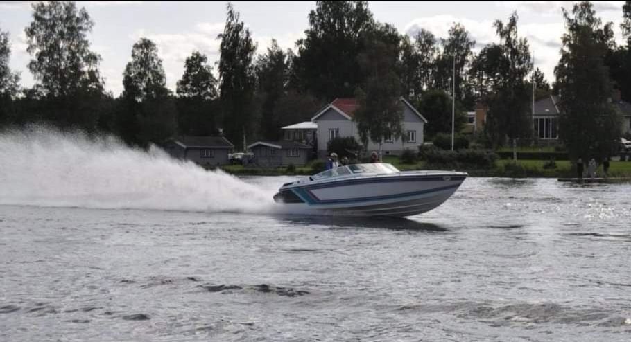

TwinAfter all, both hulls are about the same size and weight.Twin stringers probably do a better job of connecting everything with the transom than a single center stringer - especially since they can form an ongoing continuation of the twin stringers that already run almost the entire length of thr boat - all through the cabin, underneath the cockpit and onto the bulkhead in front of the engine compartment. That is - of course- if done correctly, which is quite an extensive job. Here are two pictures of the British boat, converted to a single engine:

Originally Posted by TomZ
The 272 has always been a twin engine boat. Are you sure you’re not looking at a 271?
100% Sure:
Scarab Viking is offline

One of those looks like it maybe a 292.
I wouldn’t consider these as being good alternatives to the Pantera.
The Formula is a very heavy boat for its size; the weights listed by Formula did not include fuel, oil, water, and gear.
Take the 311 for instance - it’s advertised as weighing 7400 lbs - not even close! They weigh about 2k-2.5k lbs more ready to run. And that doesn’t include the water that they’ve probably soaked up over the years either. 9500-10k lbs is probably more realistic. The 272 isn’t much lighter and a 292 is just a couple hundred pounds off. I think the 272 comes in around 8k lbs - remove a drive package and you’re at 7k lbs.
A single engine Pantera 28 weighs in at just under 6k lbs with fuel per owner comments here on OSO.
