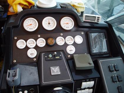

Here is picture of my Dash--I'd like to make an insert thatwould fill inside the entire perimeter and have gauges mounted on new acrylic woth yellow colr to match paint.
Can anybody suggest simple way for non-machinist/non-engineer guy to make pattern without learning new trade ???

Fortunately aluminum is easy to work with. Make you a template out of poster board and tape it to the aluminum, cut with a band saw or jig saw, sand/dremel the edges and either power coat or epoxy to the color you want.
