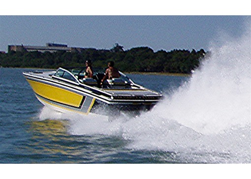

My boat is an 86 302 SRI. I was rafted up to a 353 a while back, and the 353 isn't more than two feet bigger than the 302. The problem with the older Formulas is most were equiped with TRS drives. To get the speed you are looking for, you'd be tearing up the TRS. Some of the Formulas came with Kaama drives, which can handle the power needed better than the TRS. The Kaama's are also faster because they have less drag than a conventional outdrive. The previous owner of my boat said it would do 78.6 on the gps. I haven't run it that hard, but I have no reason to doubt him. It came with 454/420's.

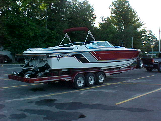

My 357 454's kammas 450hp 67mph. Some chop will really help the 357. Not a flat water boat.
