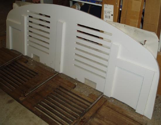

I had installed a teak swim platform originally and now upgrading to this prototype we made out of Starboard with a 34" projection from transom. It's going to mount just at the top of drive gimbles which places it 1" above the water at rest. That's where teak platfrom was mounted and made it perfect for any use.
Going to install as soon as my knee surgery heals up enough to "git 'er done".

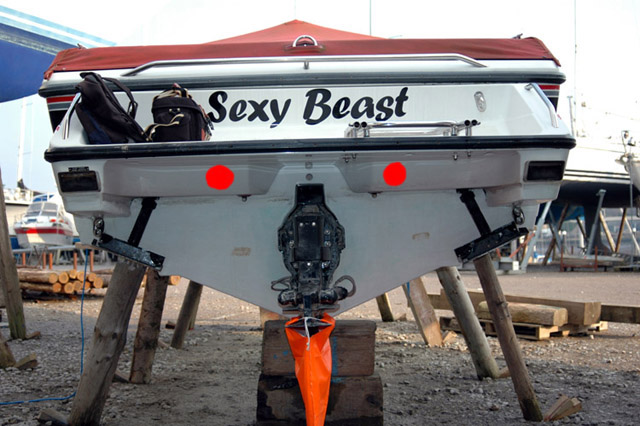

I am assuming that on the 242 the exhaust tips would exit around the red dots on the attached picture.
If thats the case, the heavy internals could be removed to lighten the platform, the original rectangular tips could be removed and made good and the new tips could exit at the points shown and be fitted with salisbury flaps to prevent reversion.
What do you think?

HAven't had a chance to weigh the Starboard platform yet--I made the mistake of loaning my PU truck to someone so I cna't get it home. Last time I was at the shop it seems like it weighed about same as old teak platfrom that's in the picture also.
I know that's a lousy answer--but at least a comparison for now.
What do you think?
You are going to have to find a reference point to determine exactly where the exhaust tips come through the transom. I believe you will find they are much higher than your red dots. On my 311, after I had modified my Silent Thunder Box, much in the same manner as the above thread, you could easily look up inside and see the short tips coming through the transom. They were probably seven inches higher than the rectangular tips. Look at the picture I'm including here and take note where my new tips exist the back of the boat. Notice the relation to the distance from the rubrail. I don't know if it's the same on your boat but what you could do is take a measurement from the inside of the engine compartment from the top of the exhaust hose to "something" then transpose that measurement to the outside and you can then determine approximately where they will exist. Hope that made sense.
