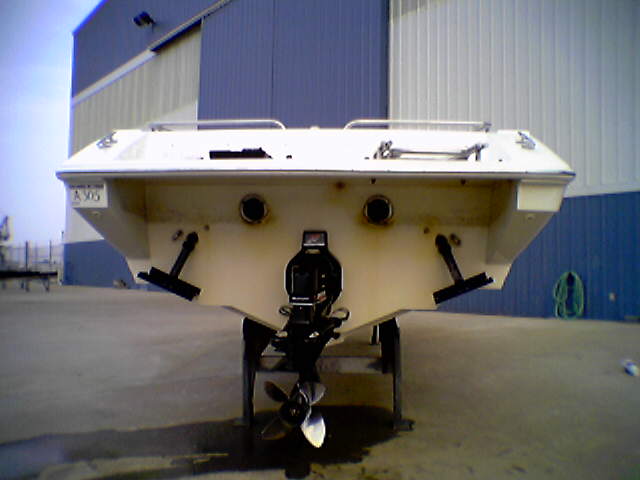

on my 271, that would not be possible at all, the silent thunder box flattens out then and turns a corner then goes out as the rectangular exhaust port. I took it off completely.
zoomer is offline

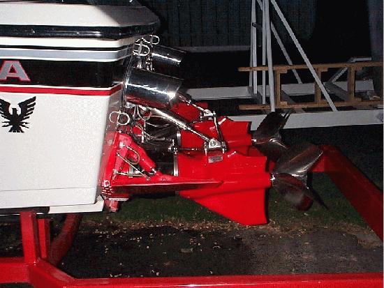

This is what Outlaw looks like now without the Silent Thunder Box...
Attached Thumbnails Silent Thunder Modification.-boatrunnning-006-small-.jpg   Silent Thunder Modification.-boatrunnning-012-small-.jpg
Formula Outlaw is offline

Having seen how much better outlaw looks, I plan on doing the same, barring any disasters. I think I might go for the 12 degree tips though.

If I can achieve as tidy a job as outlaw I'll be pretty happy.
Originally Posted by R-Don
This looks good. . .
MadMat is offline
Not an option on older style silent thunders, its all or nothing

No, that looks GREAT....
