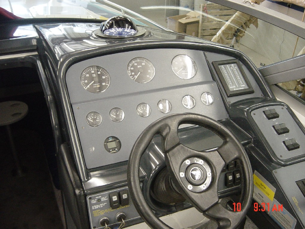

My 336 is woefully short on gauges, and I don't really care for the look/design of the current panel. Reading the other thread on panels is giving me ideas of starting over with a blank sheet of paper. Some of the gauges I'd add would be:
  • A second voltmeter (how can there only be 1?!?)
  • Oil temperature
  • Drive oil temperature
  • Ammeters
  • Built in GPS chart (would probably have to be small)
Are there any other cool gauges/monitors worth adding?
Current panel:

Maybe water pressure?

I hadn't thought about water pressure, but that's a great idea...instant notification if you lose an impeller or a water pump...

I can see all cept ammeter ....maybe ... it would indicate alt output ? if you watch voltmeters ... if alt quits the voltage will drop .... I do question one voltmeter ...unless there was a switch to check each output ....

How come there's only one??? Because that's the way it's wired.
Meter reads the output of the battery switch and that means what ever battery is selected. My 1989 has two voltmeters and the both read the same. If I run one battery they both read that one. They are not set up to read the battery associated with the engine on that side.
I added fuel pressure , oil temp and water pressure

Next season , turn on one battery and one ignition switch. Next start the other engine and watch the one that's not running. You'll see what I mean. That's why Formula dropped one guage
