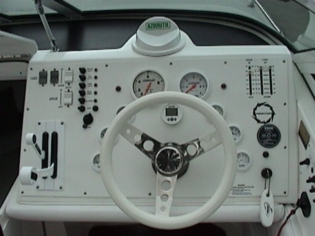

Heres a before and after pic of my white dash and with red bezels and wheel added.

Mine's gonna be all white.
The red looks nice, but i really like the clean, all white look. If i ever have to do any paint work, my boat will be all white, no graphics, nothing. I just love that look.
