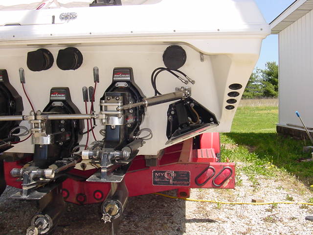

Does the center engine exhaust through four holes on the curved part of the hull below the platform?
Cool Trips is offline
Old 04-26-2006 | 11:20 AM
tomtbone1993's Avatar
Posts: 15,491
From: LAKE CONROE, TX
Default Re: Triple application??????
yep, it has a flush 4" tube that leads to the other holes

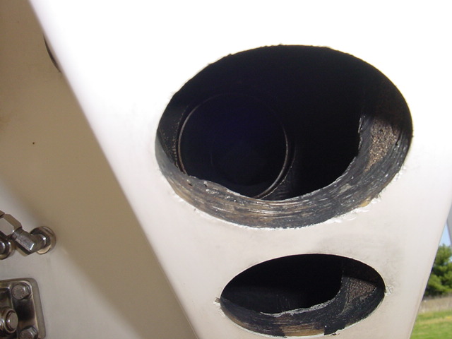

I had to look There is a flange on the inside of the transom. The pipe stops even with the hull inside the "molded platform" Its called using the boat as a muffler Its not bad when your moving but it does shake the boat when your at the dock.

Old 04-26-2006 | 12:31 PM
Posts: 15,491
the second picture is perfect!!!! so how does the stainless tube mount to the hull?
tomtbone1993 is offline

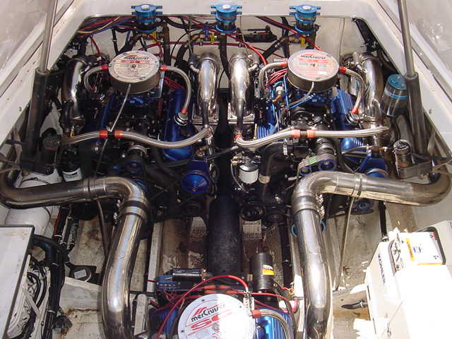

Old 04-26-2006 | 01:19 PM
Cool Trips's Avatar
Joined: Nov 2004
Posts: 149
From: Pitman NJ
There is a pipe with a flange welded to it. The flange is screwed and sealed to the transom. The long pipe hooks to that with exhaust hose. I know its dirty, I'm still spring cleaning
