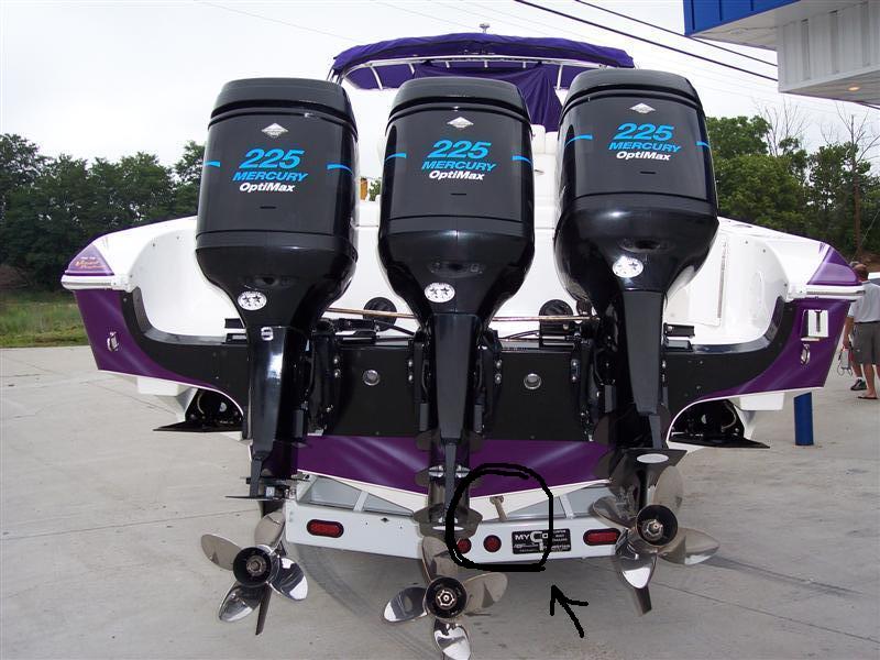

Why can't you mount it on the transom like this?

Needs to be easily reachable from my slip and prefer not to have to crawl under the boat. In order to remove the drain plug, I have to lay on the lift tubes and scoot under the boat. Just to much hassle to have to do that every time to hook up a pick hose that will drop down into the lake. Also, that would put the seacock under the motors. From a plumbing perspective, a night mare.
