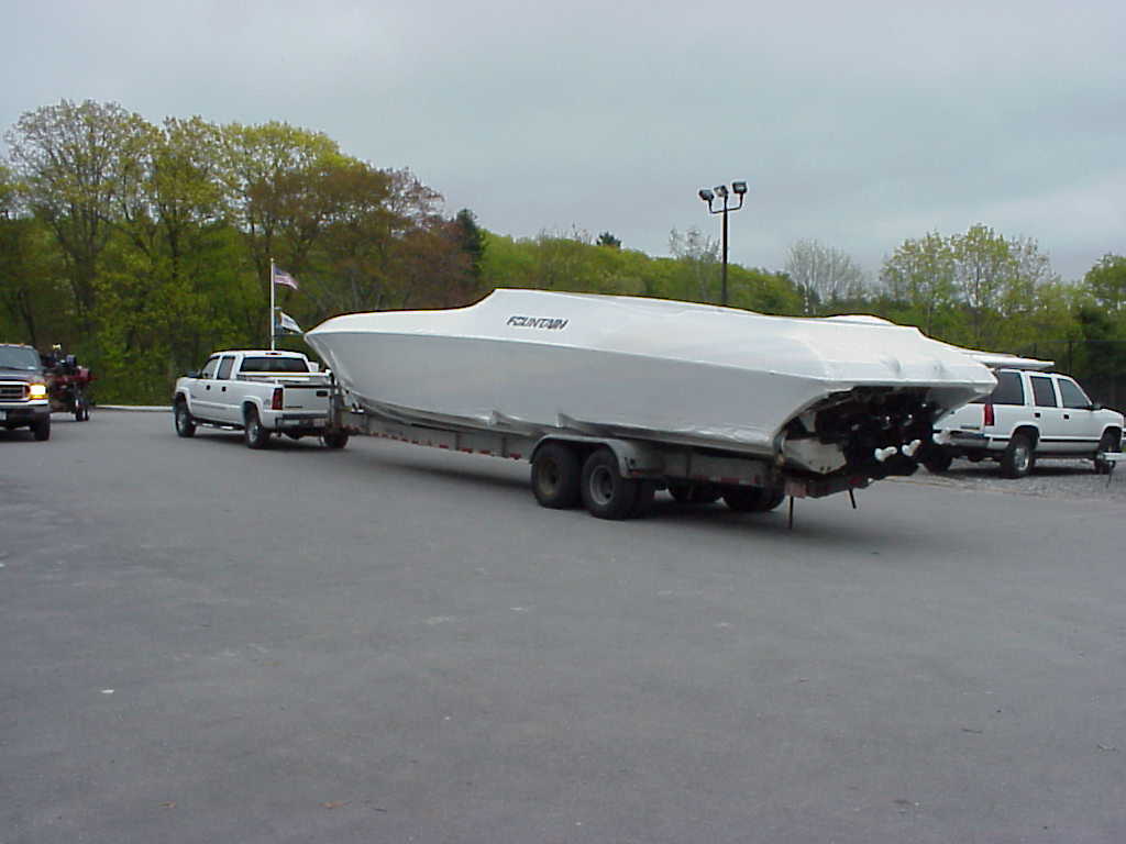

Ive seen it Done it is a nail biter!!The one in the pic came up to Mass from Washington the driver said it was ok but (Im glad I was not driveing!!!)
