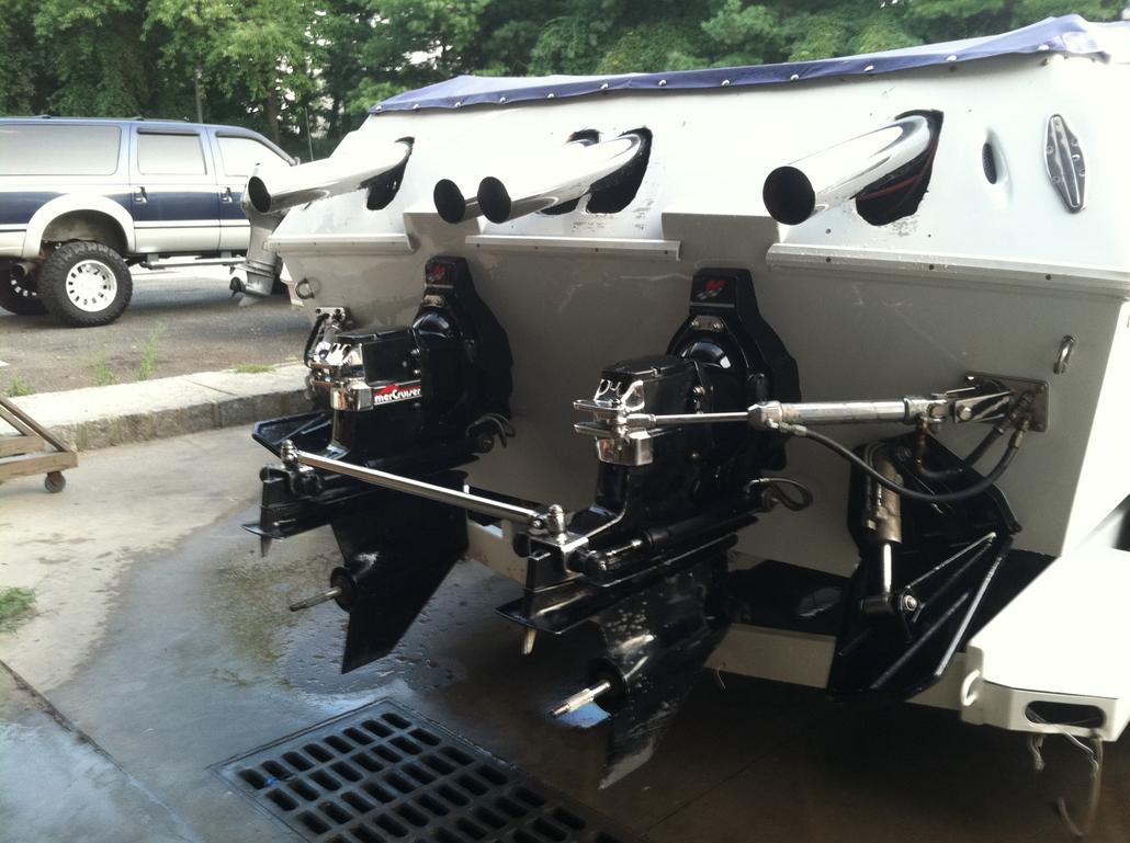

A few pics

10 Meter-fountain-002.jpg When it had the number 3's

looking good.keep us posted.

Thanks for the reply the boat looks great, let us know how she runs once you have time to get it really dialed in
