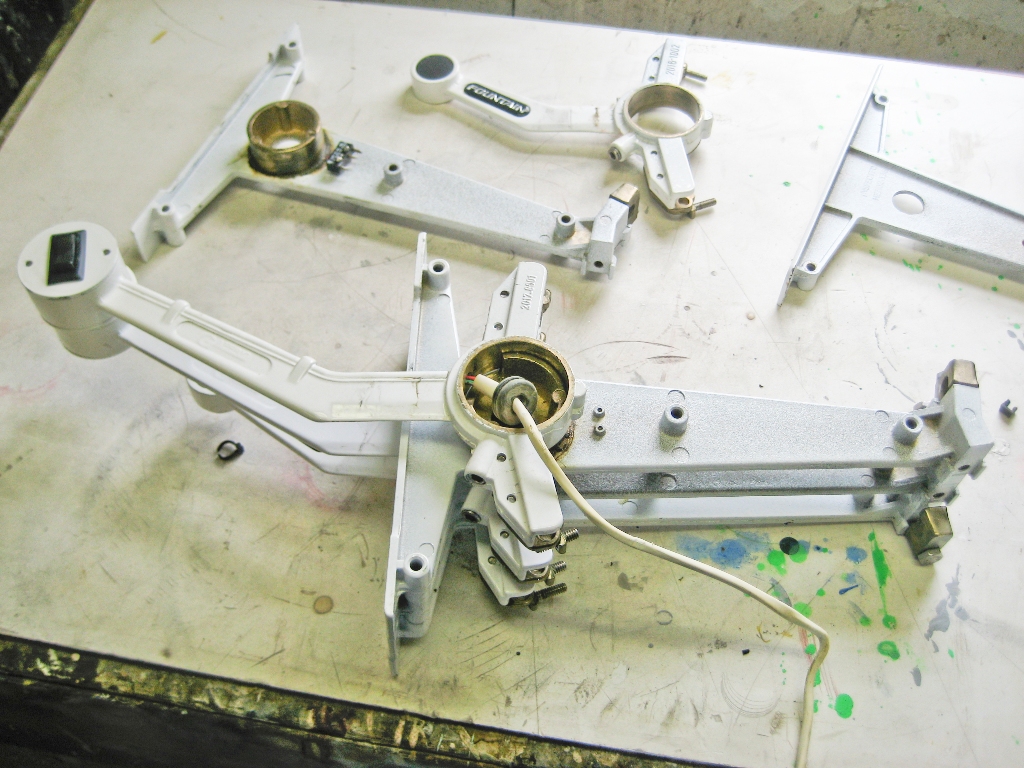

As stated above, you can access the set screw at full throttle between the rubber inserts or from below. Throttles have a spring under the set screw that pushes a piece of delrin (plastic) into the hub for friction.

here you go, this may help.
You are trying to get to the set screws you see pointing down in the picture.
