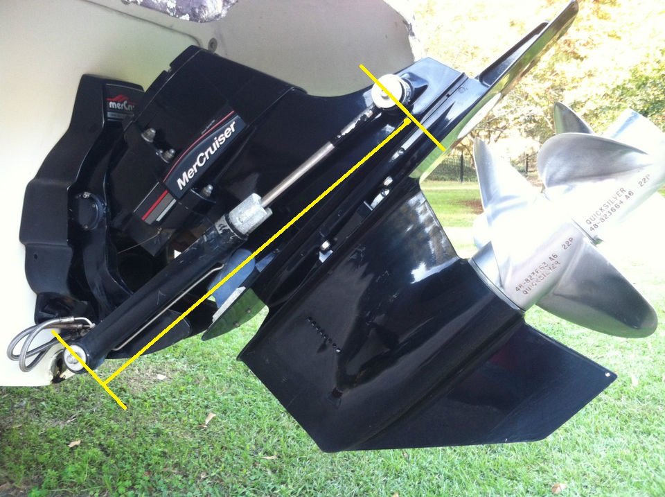

Maybe I missing something but I don't have the "trailer up" positioning so where to base measurement? So 21.75 from full in then mark on indicators I'm assuming? And out of curiosity, yes she's a little older, but what are the age limits to be considered "vintage"?
measure mounting point to mounting point on the trim cylinder... so measure the yellow line distance,, Trim up untill that distance is 21.75" and note.mark your indicator, You will be fine trimming the boat to that point while running.
[ATTACH=CONFIG]542897[/ATTACH]
Got it, thanks!
