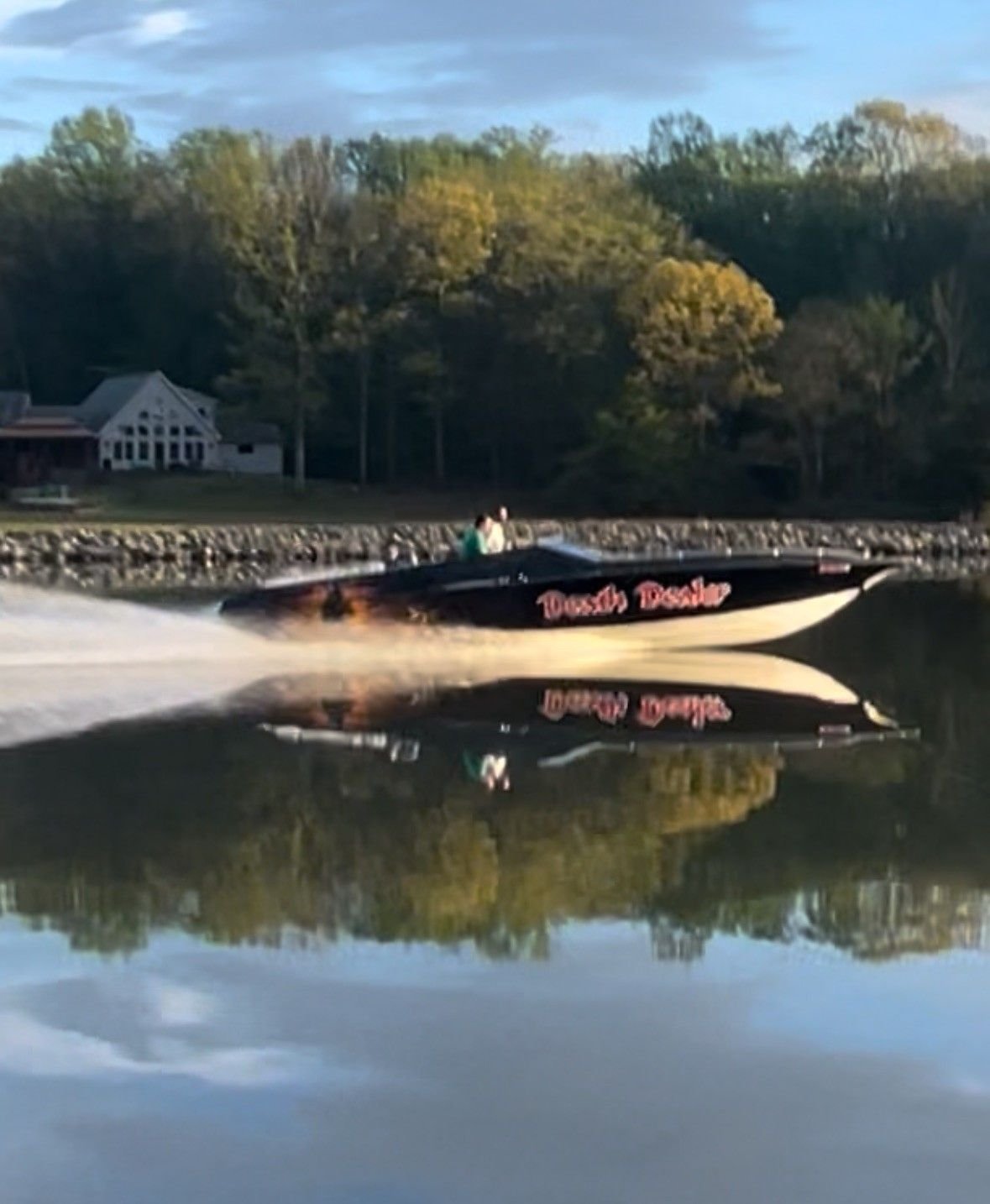

Happy to help. Unfortunately you will all have to carry the torch on future testing. Have moved into a staggered 42 with 6s. I figured these pics may help folks with the above on angle of attack and the differences shorty's made on a 35 straight bottom.
3 Blade 5.865" Under- Sits back and runs entirely different. Tail wet.
4 Blade 3.865" Under boat ran entirely different, much flatter and got the back up with the 4 blades spinning in and ran on the variable pad and notch much less wet.

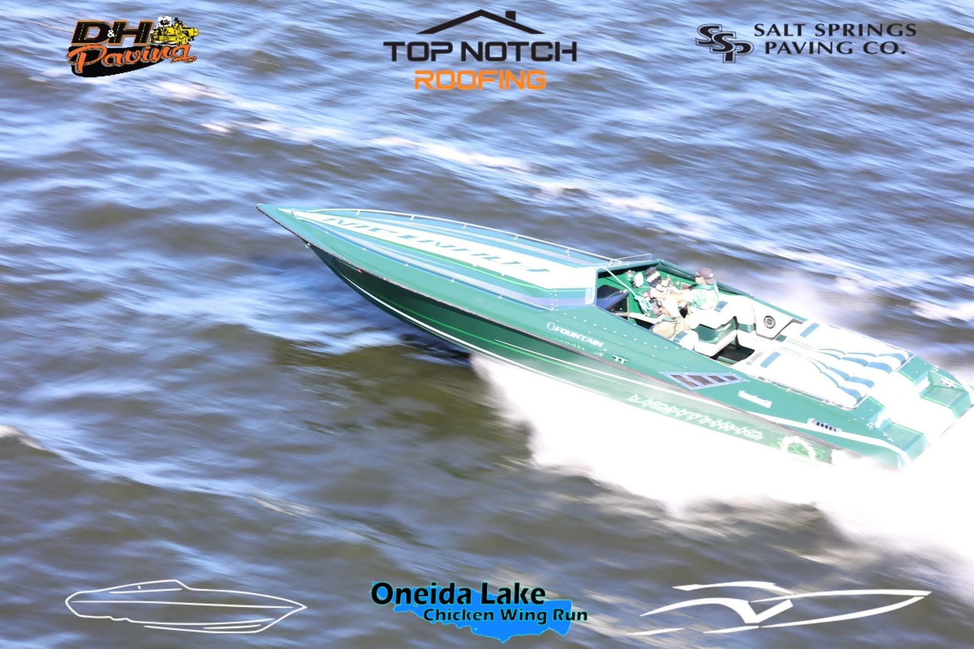

I replaced my side louvers that leaned my AFR numbers up added some jet and I hit 106

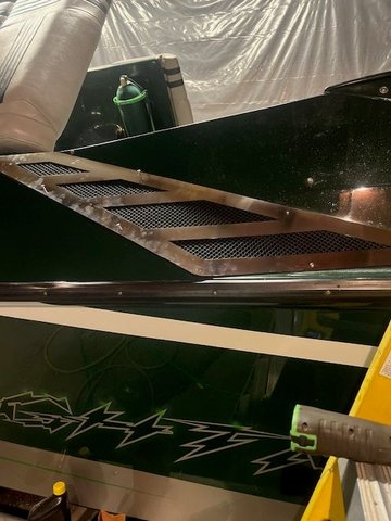

Green lighting Do you have picts of the side louvers you went with?

I had a local guy to me cut them out of stainless and I polished them

How much did you notice a change? Half a point leaner? What wot afr did you aim for? 11s?

Yes I was shooting for some where around 11.5 under load at wide open throttle . I was chasing a problem where the faster I went the richer it got. I determined when testing the louvers I was going in a good direction when I only put the starboard side on and that engine leaned up. When I put both louvers on and cut the fiberglass behind them , my AFR numbers went up 2 points but that was also after I had taken a lot of jet out of the carbs trying to correct the rich condition ,
