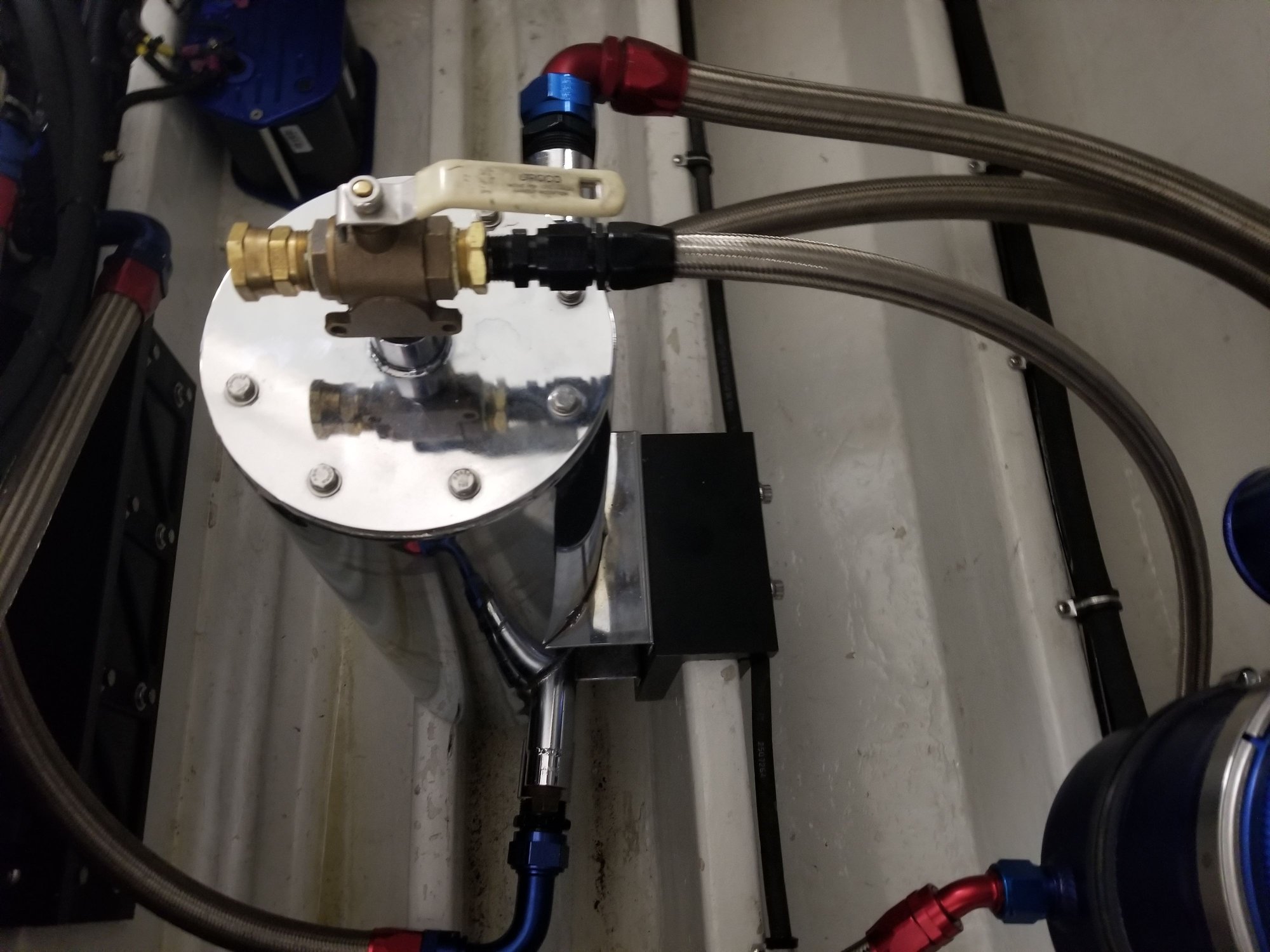

The hose connected to the shutoff valve is an air bleed. It exits low on the side so when the boat is off plane it is underwater. That way it doesn't suck air. When under way it bleeds any air that is in the strainer. You can fine tune your pressure by the size restrictor you use in the hose. When we are going it pushes water out this is how I am sure we have enough flow.

a few pictures of the engine bay
