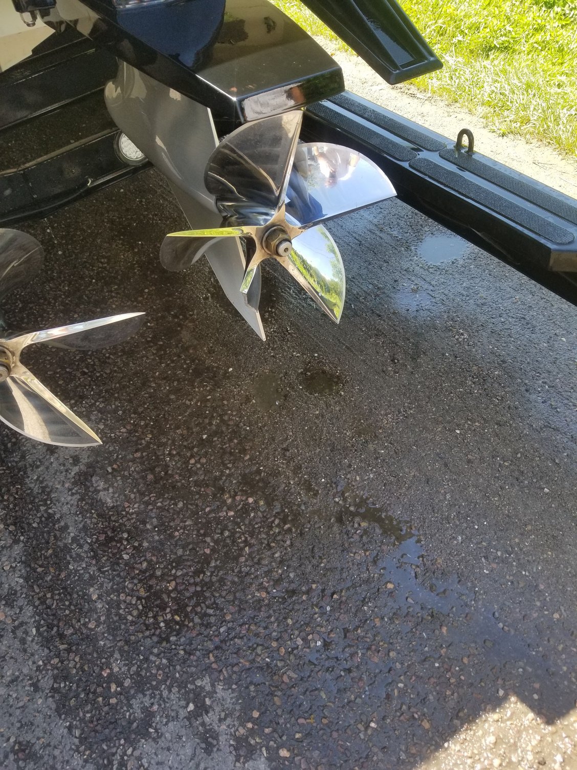

Old 08-20-2022 | 08:17 PM
  #519
Joined: Mar 2011
Posts: 943
Likes: 277
From: So. Burl. VT.
Yikes
KWright is offline
Old 08-21-2022 | 06:06 AM
  #520
Joined: Jul 2007
Posts: 3,337
Likes: 860
Ouch!
Did it at least break clear or did it smack/damage anything on the boat when it let go?
