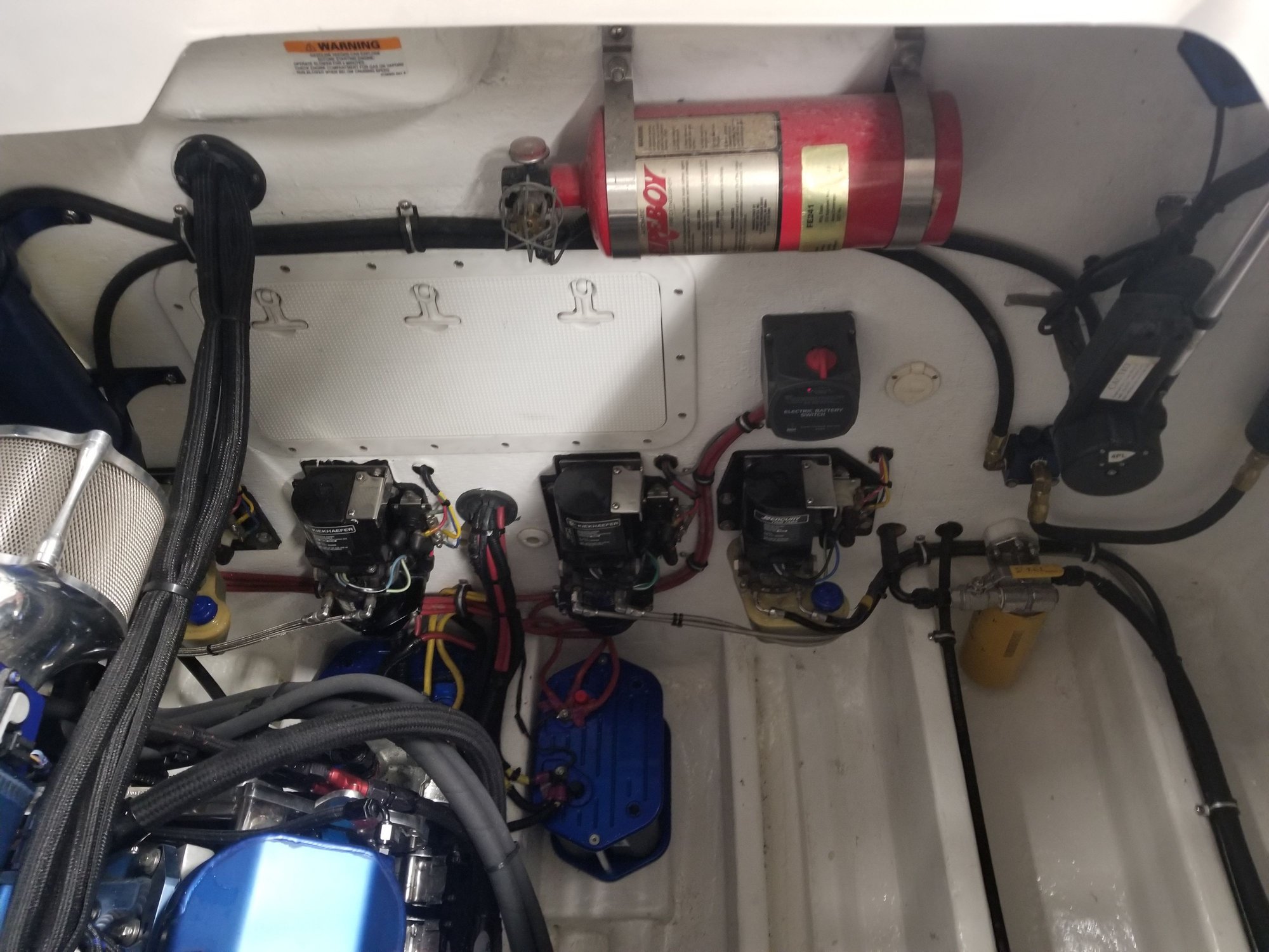

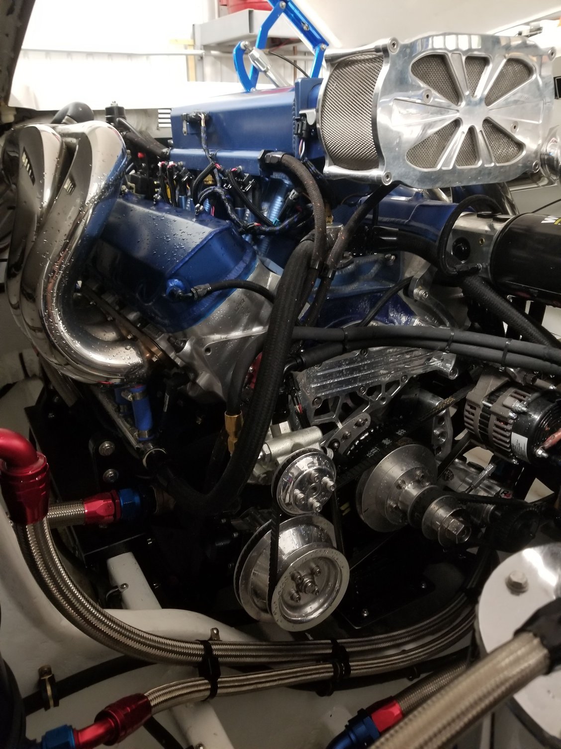

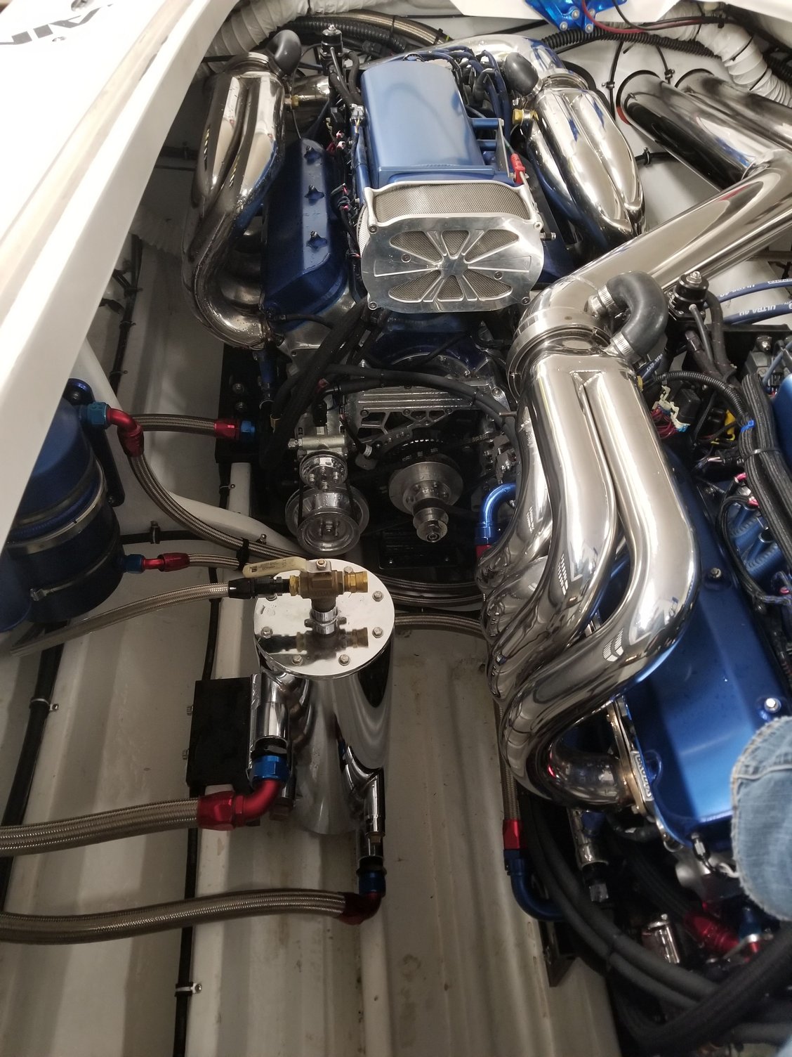

KWright 06-03-2020 01:31 PM
https://cimg9.ibsrv.net/gimg/www.off...ba341e7366.jpg
https://cimg1.ibsrv.net/gimg/www.off...89dbac50c6.jpg
https://cimg7.ibsrv.net/gimg/www.off...6841f0e53c.jpg

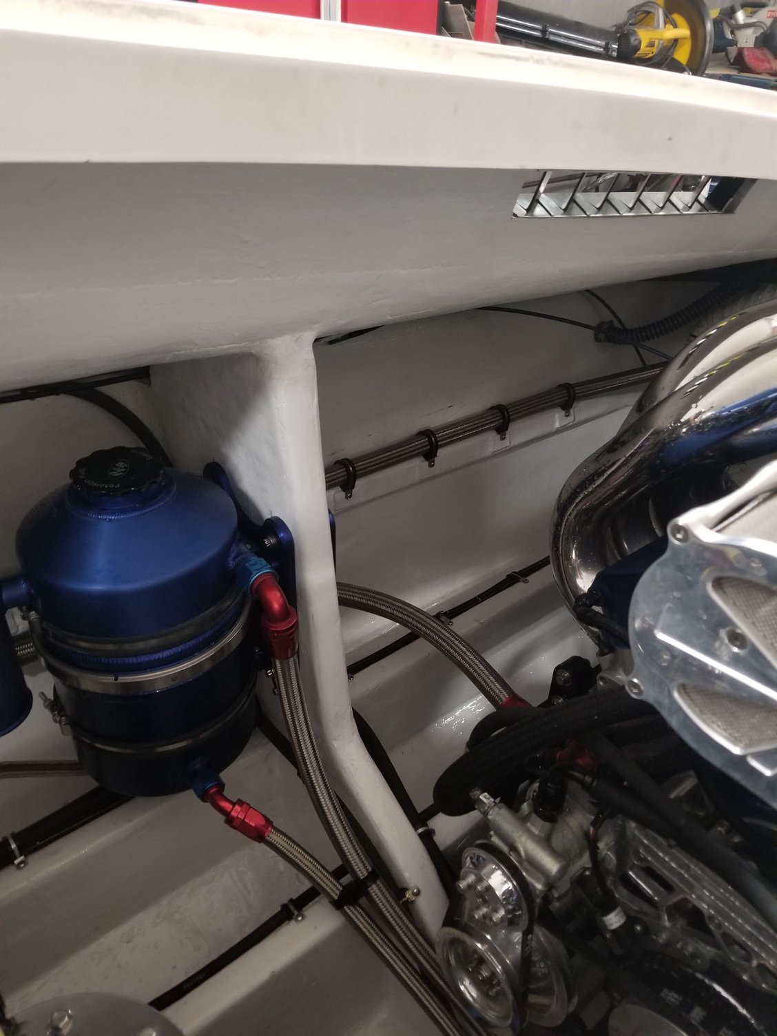

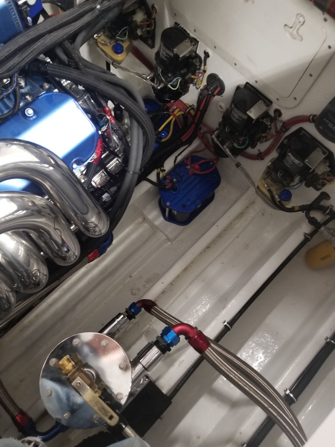

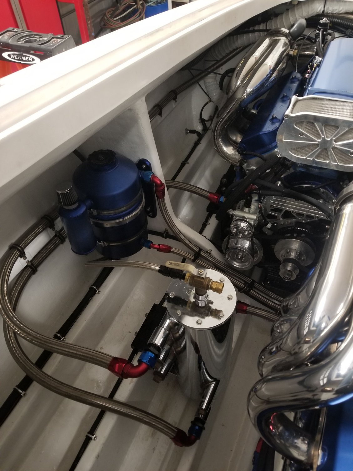

KWright 06-03-2020 01:34 PM
https://cimg7.ibsrv.net/gimg/www.off...ce0a73bd83.jpg
https://cimg2.ibsrv.net/gimg/www.off...91d2f3722b.jpg
https://cimg7.ibsrv.net/gimg/www.off...7ca54b88c0.jpg
RAPTOR1 06-03-2020 06:09 PM
Beautiful rigging Keith, nice touch with the 12 pt fasteners! If those sheet metal intakes don't meet your expectations I want to be first in line, lol. Charlie
boostbros 06-03-2020 08:32 PM
ill never forget blowing the hoses off the oil coolers the first time we went north of 150 the water pressure really builds quickly at 170 i think it was over 400 pounds into the strainer..... its quite a balancing act to have enough at low speeds and not blow things apart at high speed....... intercoolers do not do well over 20 pounds of pressure even well taken care of they have a short life superchiller says 3-5 years...... awesome job on the quality rerig!
KWright 06-04-2020 12:03 PM
Thanks for the compliments, most of it should go to my son Shane he has been the one that has done most of the contortionist moves to get this project to where it is today.
