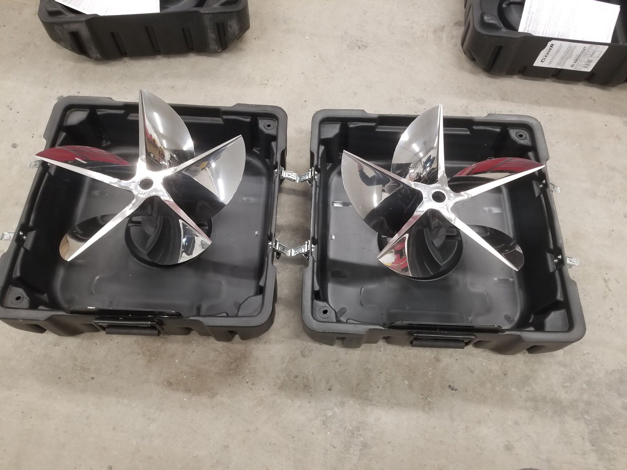

New props on order. Mercury 5 blades. 900hp 17.25 diameter, 31 pitch, 15 rake. Mid February delivery. Hopefully.
I have some Herrings pretty close to that if you're interested. BBlades did some work to them, they may measure closer to 31" per the prior owner of them. They are like new....

That's a good deal I definitely need more diameter.

New props are here. 17.25 diameter 31 pitch 15 deg rake. Old ones 17 x 30 x 18

Those props probably cost more than my whole boat did. Beautiful.
