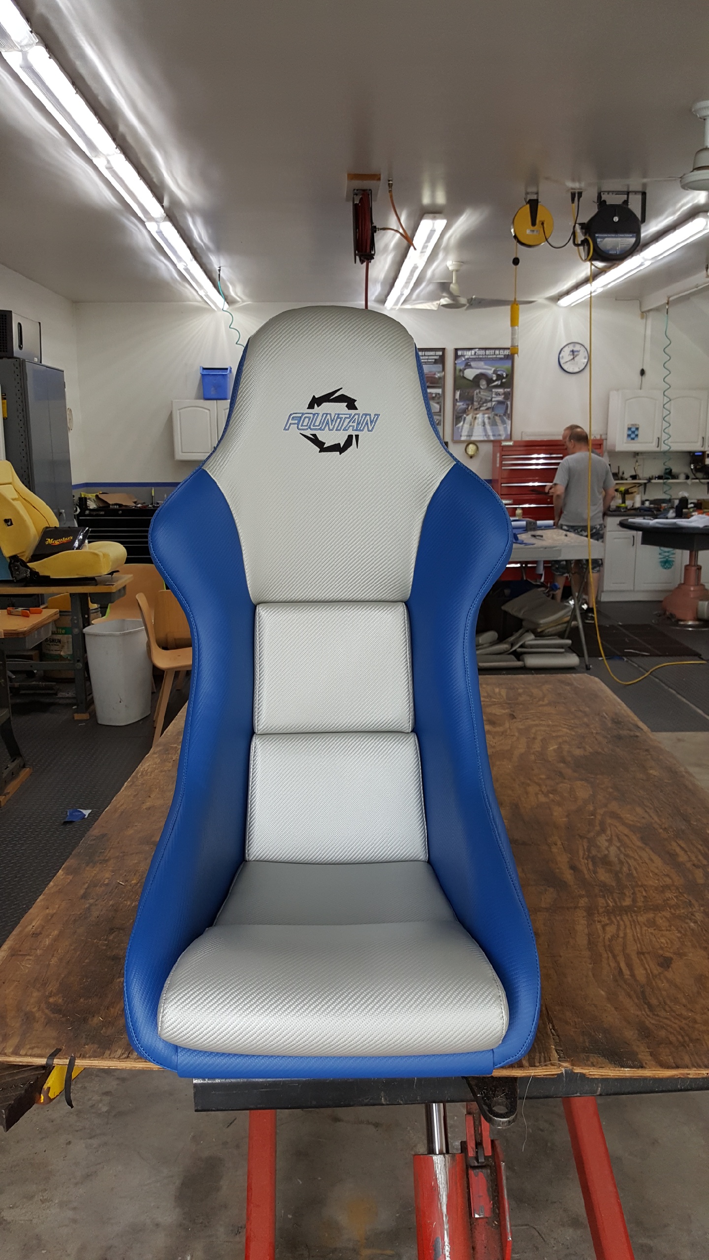

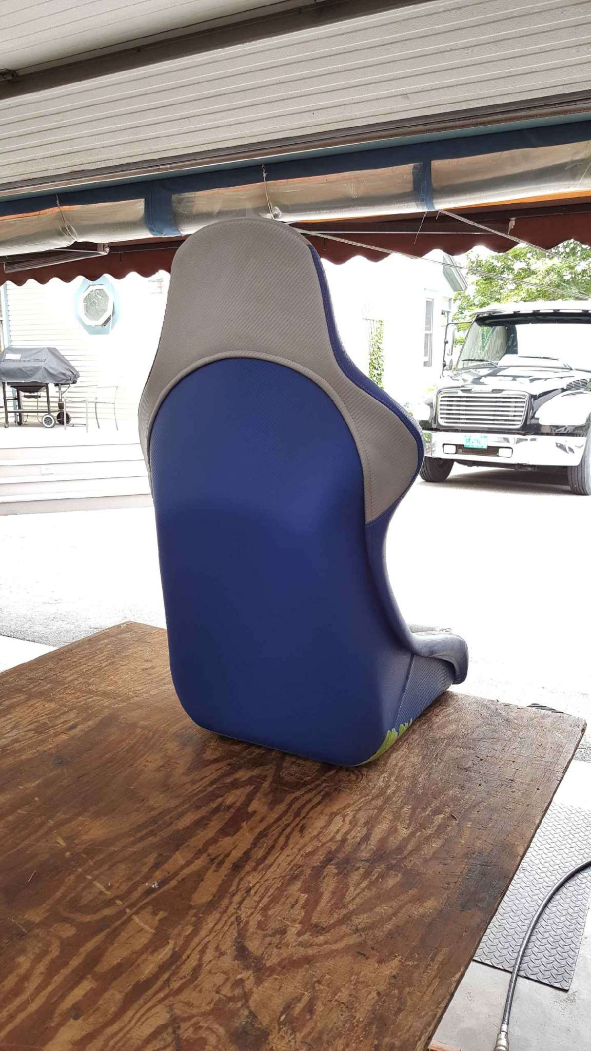

Attachment 570035Attachment 570036
Seats being finished up.
Crude Intentions 08-14-2017 06:45 PM
Those seats look awesome.
dykstra 08-15-2017 06:43 AM
Coming together nicely. I can't wait to see this azz kicker finished!!
KWright 08-18-2017 10:19 AM
Ok I found a spring manufacturer that will make softer springs for these seats. The coil overs that is on these have a 250 in lb spring rate. Way to stiff. I found someone who will make some at 110 in lb. Pm me if you want info.
KWright 08-18-2017 05:45 PM
2 Attachment(s)
Attachment 570118
Seats are back. Just need to finish making new bronze bushings for rear seats. New springs for coil overs ordered.
