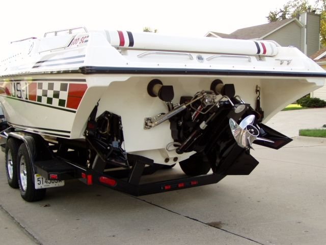

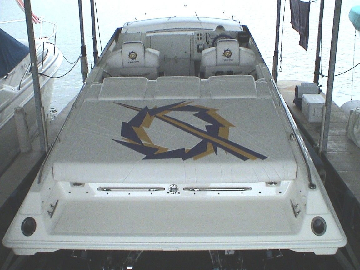

my 27'
my 32'
The sunpads are stapled to plywood. At the rear, Fountain just cut a strip of plywood with an angle on the end and stapled that piece to the main plywood base to give it the downward slope at the rear. If someone has sat on the rear and pulled up on that angled piece it probably came unstapled and is a little flimsy. On my 32, I epoxied that piece back on and then put a couple strips of glass on both sides of the joint to make the rear solid. So you either have a loose fitting rear piece, or someone did a short cut and cut corners.
