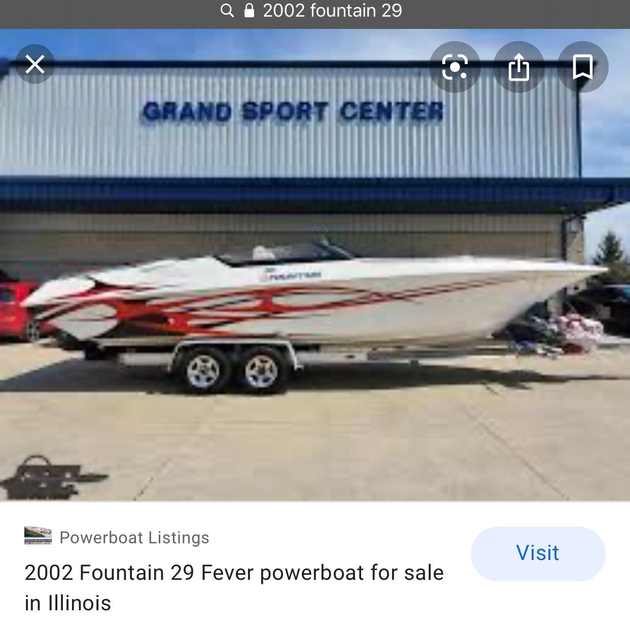

Some 2002 29s are the old style Fever. They do not have an anchor locker and getting over that windshield is not easy.
The 29s with the frame windshield are much easier to cross.
