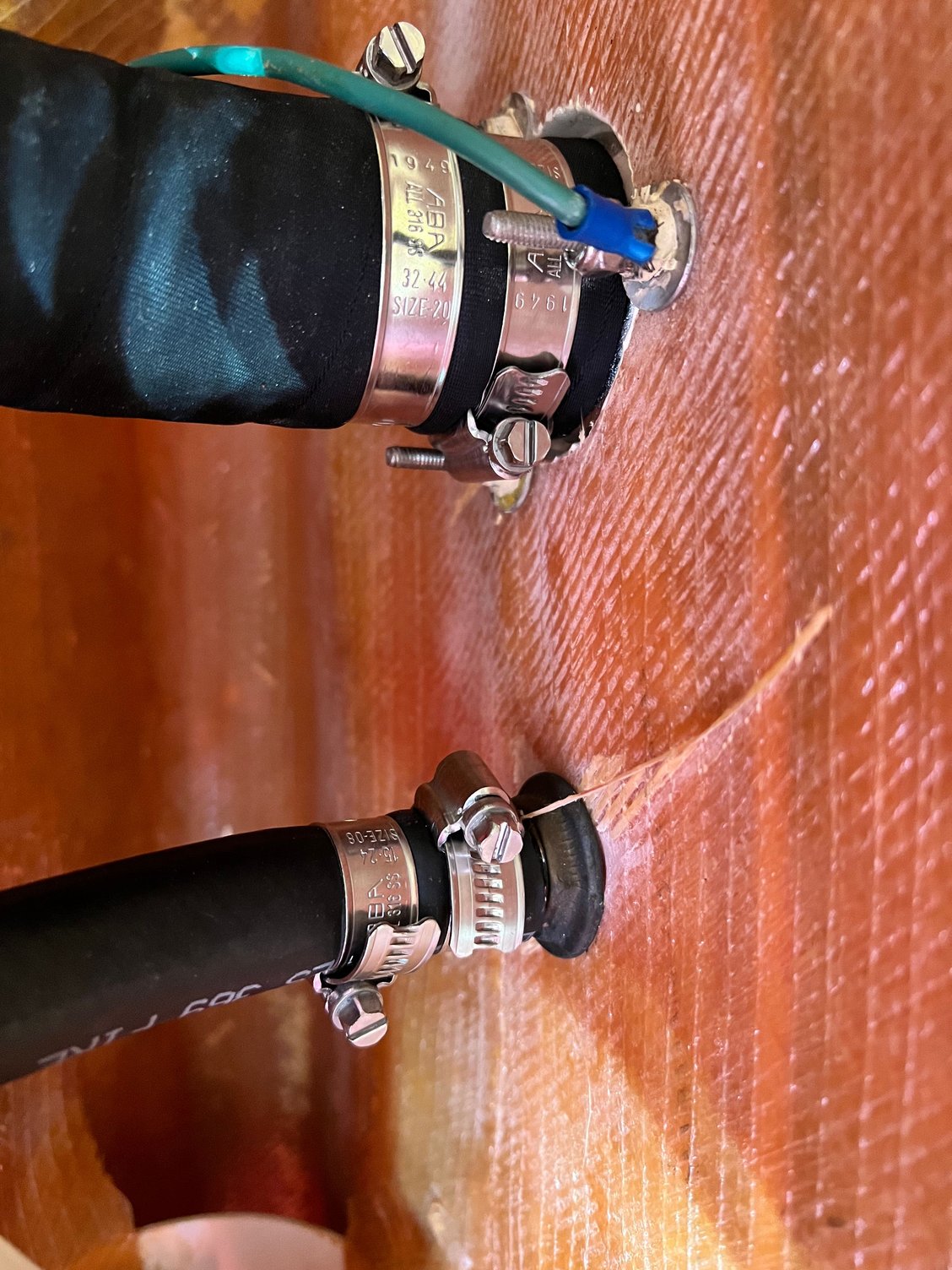

I do on a 32 and had to change mine. Its a 2000 model.
First buy a bore scope on amazon, they are cheap now and will help. Lets you get a look at what you will be cutting.
there is no access panel where they connect, you will have to cut one.
Mine did the same thing and looking after I got the hoses off when you bent them you could see some cracks, replaced and all good now.

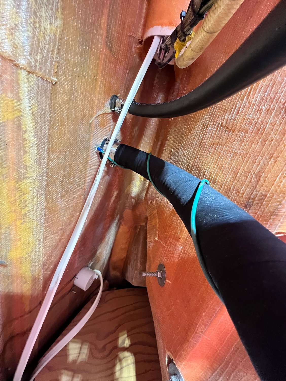

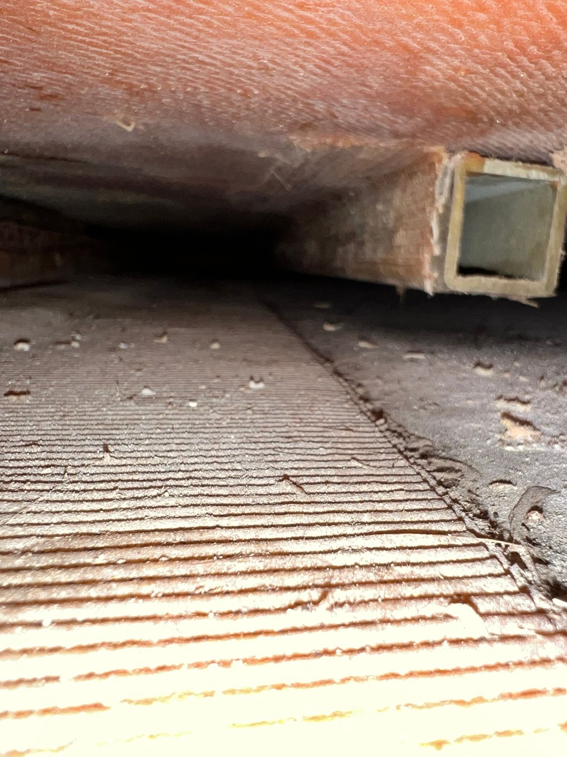

Distance from floor to tank.

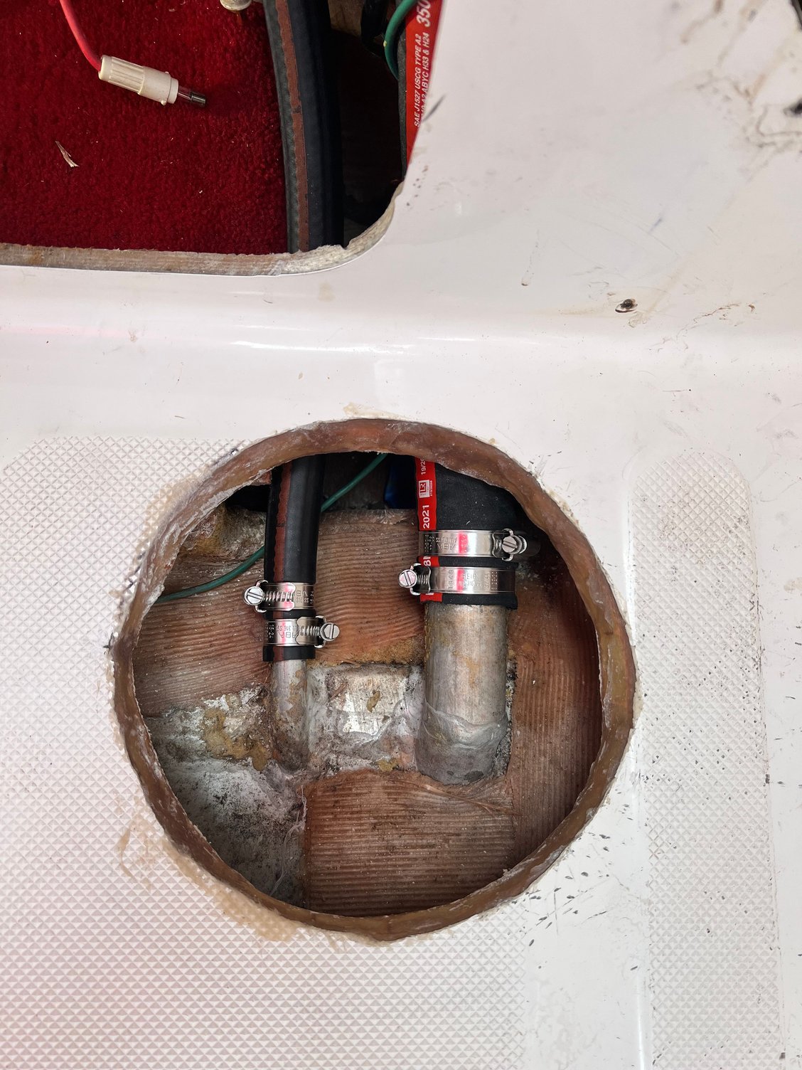

New access hole.
New hoses installed.

These pictures are great. Do you think the Fever 29 has the same configuration on the filler neck and overflow connection on the tank? If so how did you cut the floor without nicking the hoses. When complete did you hinge your opening?

get one of those scopes and look real good so you know how much room you have. Who cares if you hit a hose, changing anyway, the tank would be a issue.
no did not hing the opening used 4200 to seal a cover over it. Hope I never have to open again!
lol
used a little pencil air saw, glassed all the opening up when done.
