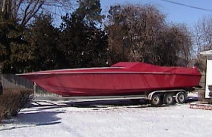

I have checked out your site looking for info in the past. I Need big time help with the drive hieght issue. Also wanted to hear about torque issues with single drive and high power.. Here's a pic of the hull

I can't help with drive height, but if anyone would know, the folks at Fountain might. Try to get ahold of Gail Lane and see if she can get you in touch with Jeff Harris or someone knowledgable in the rigging shop. Tell them what you're trying to accomplish, and I'll bet they'll be interested in talking..
How do you plan on dealing with the keel? There's a big fat stringer running up the center, and I'm wondering how you would get the turbine low enough in the center for a reasonable driveshaft exit angle. That question would also apply to setting up one with a single piston engine. Just curious...
