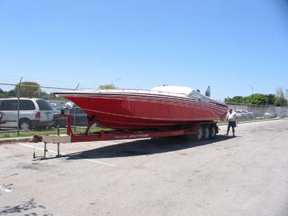

SubscribeHello everyone you have a great form, I am new to this sport..and I need some experienced guidance, this is my situation, I have just acquired a freshwater 1990 Fountain Fever 36 (38 with platform) the hour meter reads 650 hours, it has twin Merc 525 SC, with Merc blowers. One of the engines starts fine runs a bit rough, been told a good tune up would fix it, but the other has water in the oil, it turns over slowly and will not start. I would like to do the right thing with these engines, Rebuild the both of them, I have been told it would run me 10k to 16k a piece to rebuild, which is a bit out of the budget for now. So my question is....

nice....
Nice boat. Don't be disappointed about not getting you new baby to the water right away, the hobby is FAR more enjoyable when the boat is reliable.
